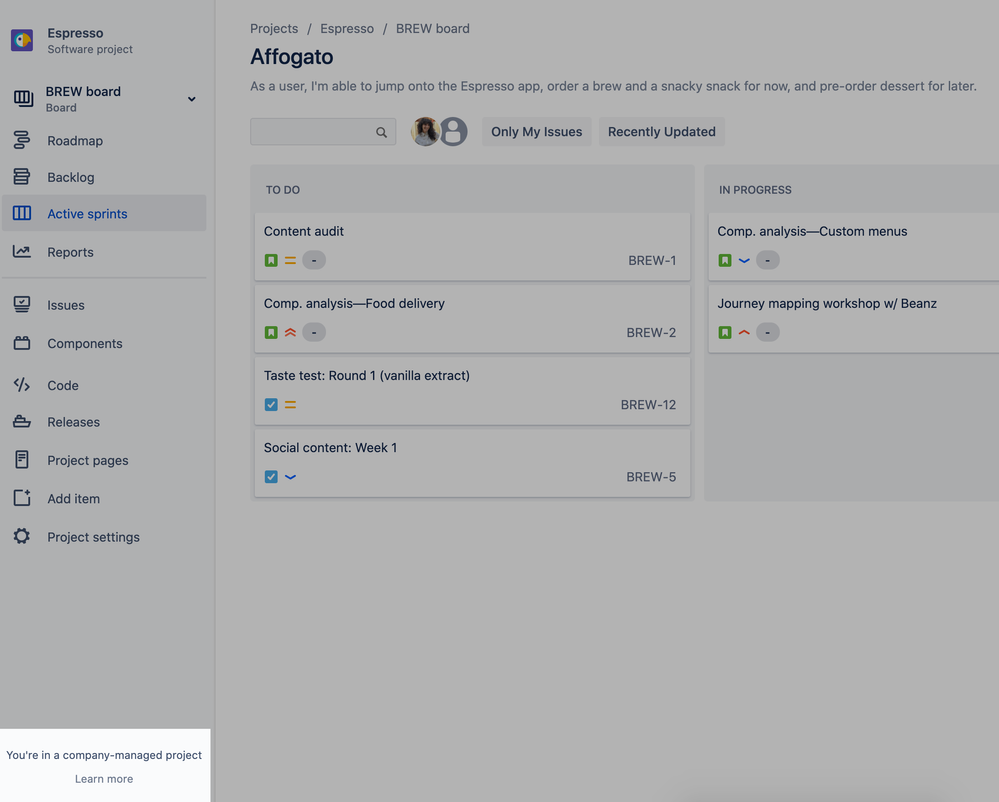

How to know if I’m working with a Company or a Team-managed project?
You can tell the difference between team-managed and company-managed projects by going to your project sidebar.
In team-managed projects, the bottom-left of the sidebar says you’re in a team-managed project:
In company-managed projects, the bottom-left of the sidebar will state you’re in a company-managed project:

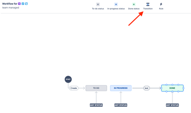

  1. Navigate to your project > Board > Manage Workflow
  2. Click on Transition to create it:
