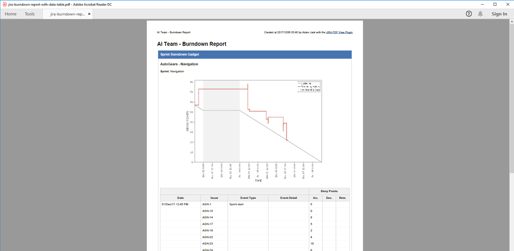

You can implement this using Jira dashboards and the Better PDF Exporter app. It can export dashboards to nicely formatted PDF documents which can capture a whole agile dashboard (with various gadgets):
...or just the Burndown gadget. Note that with the burndown gadget you can display the sprint events which include "issue added", "issue removed", "estimate changed", "sprint started", etc. This is what you see under the chart in this sample:
You can check these examples here.
And, you can fully automate sending these PDFs attached to custom emails using the free Better PDF Automation app.
