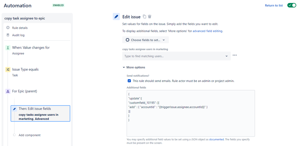

@Trudy P Claspill I try to call assignee of the child but in below jason it call per user so what should I change so I can call the assignees of child?
"update": {
"customfield_xxxxx" : [
"add": {
"accountId" : "yyyyy"
Please show us the rule you have constructed.
And the first post link I provided shows how to reference a field in the child issue, if it was an event in the child issue that triggered the rule.
The first post link I provided shows how to reference the Assigned field in the child/trigger issue.
"update": {
"customfield_10195": [
"add": {
"id": "{{childIssue.fields.assignee.accountId}}"

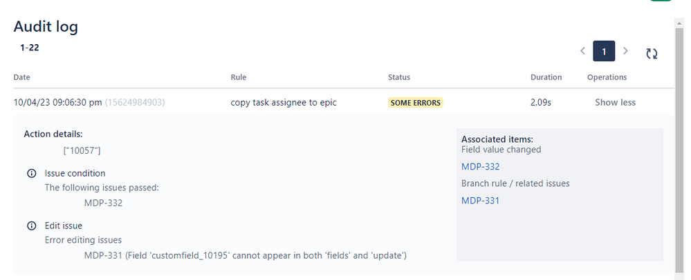

but it give following error
MDP-325 (Field 'customfield_10195' cannot appear in both 'fields' and 'update')

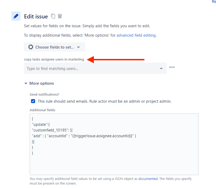

Have you shown us everything that is in your Edit action?
Looking at the second to last response on the first post I linked, it seems like the JSON code should look like this:
"update":{
"customfield_10195": [{
"add" : { "accountId" : "{{triggerIssue.assignee.accountId}}" }

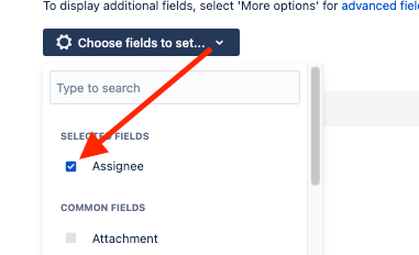

The problem is that you have specified the field to set in both the JSON code and in the Choose Fields to Set section above the JSON code.
You can't have the field in both the Choose fields section and in the JSON code.
You need to click on the Choose fields to set pull down and uncheck the copy tasks assignee users in marketing field. In my example I have the Assignee field selected.
@Trudy P Claspill thankyou so much its working fine
