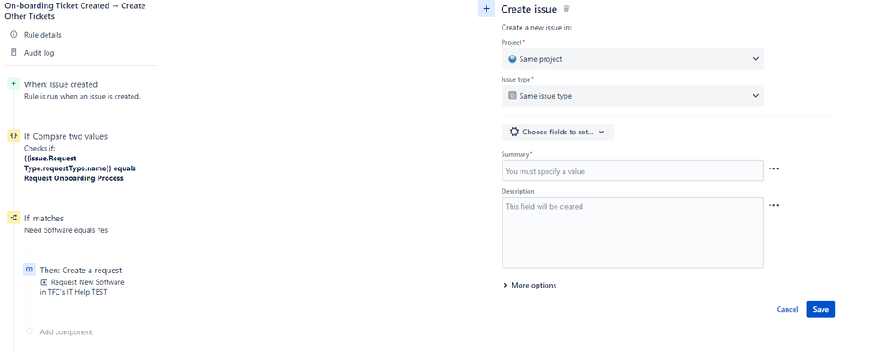

Next I tried doing this:

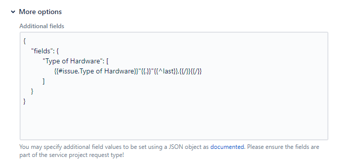

Which came back with an interesting error:
Anyone got good ideas for me to try?

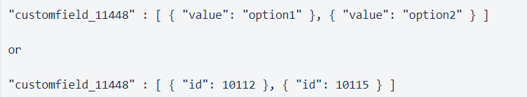

But I have no idea how to print it as such.

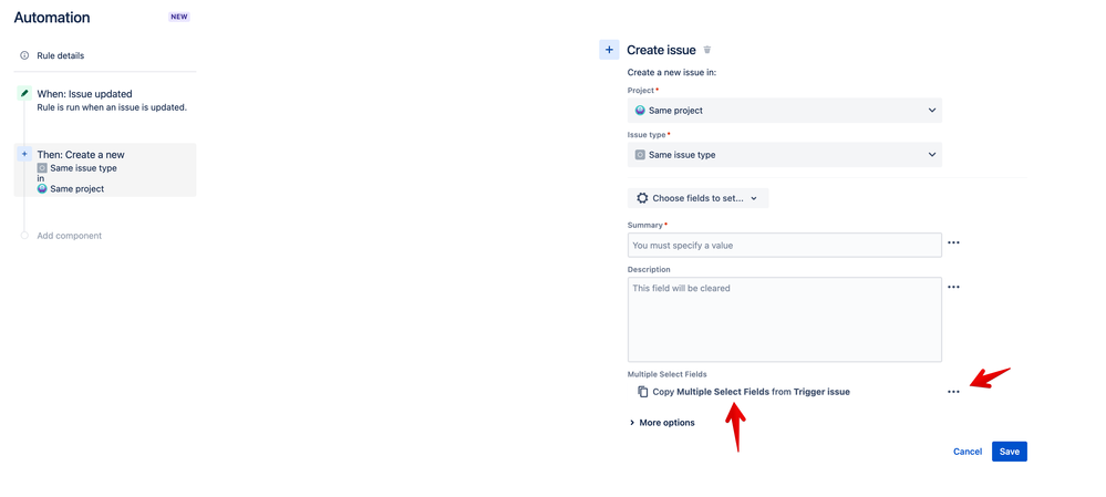

Is Issue B created from a rule that is triggered by some event from Issue A? If so, you should be able to do this:
Create.pngThis is my example multi select field. By using the ... menu I have put it into copy mode and told it that when it creates the issue it should copy the values for that field from the issue that triggered the rule.

Hi Simeon,
Yes, issue B is created from a rule. When issue A is created, automation checks if issue A's request Type name equals to "Request Onboarding Process". I did a few test cases and it recognizes when that specific issue is created. Then automation checks its fields. I set up some boolean flags for this. If a flag is true, then issue B is created. At that point I want a specific field to be copied over. Both issues have the same field.
I looked at your solution and I do not get the same "Copy Multiple Select Fields from Trigger Issue" option. Is it locked behind a version/license? We have the premium version.
Sergiy Yermak
June 6, 2022
Ah! Choose the field to set, then click the 3 dots, "Copy from..."
Thank you for your help.
