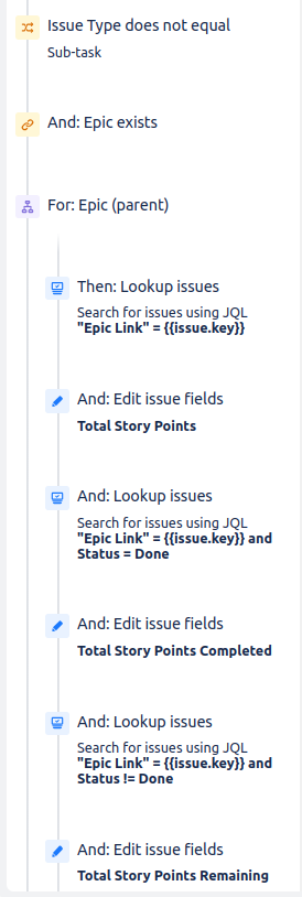

Hello,
I was able to make automatization for sum up of Story point estimate of tasks to Epics. Now I have a problem that I need to sum all tasks in epic, that are in state of : "draft, ready, in progress, review", thus everything that is not in state of "done, won't do". What would be the best options?

The rest of the automation is extended on the same flow. Three lookup issues with minor changes gives os total points, completed and remaining in a single automation.
Please see the automation below which covers all three points I've mentioned in the answer above:

@Sanjog Sigdel Thanks, but now is Jira not able to write numbers to the Total Story points left/completed. This is code I have put in the "Edit issue field" of Story points done: {{lookupIssues.Story points estimate.sum|0}} - what do you have there?
When I look in the log, it says that Epic is not meeting the conditions.

I have {{lookupIssues.Story Points.sum}} for all three fields. The jql in each lookup issues separates tickets with completed, remaining and total story points. This smart value sums the story points.
This is how it works for me.

@Sanjog Sigdel Yes, I have made it that it works, thank you very much. The last problem is the condition of "won't do". What should be the syntax? This does not work for me: "Epic Link" = {{issue.key}} and Status = Done and Status = Won't do.
I need it to count the SP of both 'done and won't do' tasks to the Total Story points Completed.

It should be like
"Epic Link" = {{issue.key}} and Status = Done AND Status in (Done, "Won't Do")
For a good practice to eliminate errors, better if you replace Won't Do to Wont Do. Just to be in safe side such that the single quote ' won't create any issue.
Please validate your JQL first from the Jira Issue Navigator then you can add it in the lookup issue query.

@Sanjog Sigdel Yes, finally it works, thank you very much!
One last idea, do you think that there could be a possibility to make this automatization "live on its own"? Because as I see it, there is a slight problem with the trigger (mine is When the field "Story point estimate" changes). It would be better if Jira  could read the task story points all the time, because it does not read when task moves from for example "processing" state to "done" state, thus the epic SP count does not change. It would need the change in SP all the time.

I have propably found better solution ->the trigger should be "When the issue is updated" and it seems to work.

I am running Jira Standard Plan so my Automation rule limit is 500. But if you have premium Jira Plan, you can run as many automatio nrule as you want. In that case the trigger can be whenever the Story Point value gets changes.
Better than the issue is updated, keep it as whenever the story points value changes, check the rule automatically.
