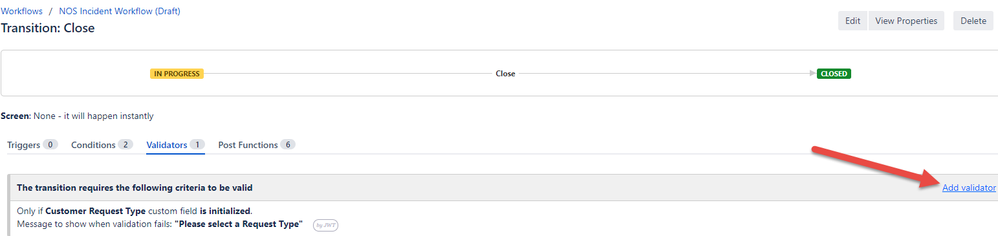

Raynard Rhodes
December 10, 2018
Raynard Rhodes
December 10, 2018
If you follow those screenshots (assuming you have Jira Workflow Toolbox) you will be able to set the conditions that need to be met.
You can choose the status or resolution the subtask need to be in for the parent issue to transition. You can even filter it based on the value of a [custom] field. Give it a try and see what happens.

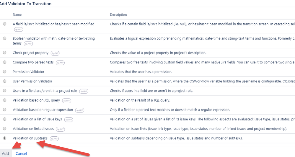

Kumar
December 10, 2018
HI @Raynard Rhodes  Thanks for your response
When I click on Validator I'm seeing only 3 options and for more options like you have in screen short Which add-on are you using ?? is that a paid add-on or free app??
can you tell me the name of that add-on
Thanks,
Kumar

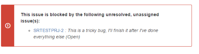

I have seen a document that provided in the scriptrunner documentation can you please help me in modifying the script
https://scriptrunner.adaptavist.com/5.4.43/jira/recipes/scriptfields/informationMessage.html
and the script is
import com.atlassian.jira.ComponentManager
import groovy.xml.MarkupBuilder
import com.atlassian.jira.issue.Issue
import com.atlassian.jira.ManagerFactory
import com.atlassian.jira.config.properties.APKeys
def componentManager = ComponentManager.getInstance()
def issueLinkManager = componentManager.getIssueLinkManager()
def baseUrl = ManagerFactory.getApplicationProperties().getString(APKeys.JIRA_BASEURL)
def List<Issue> blockingIssues = []
issueLinkManager.getOutwardLinks(issue.id).each {issueLink ->
if (issueLink.issueLinkType.name == "Remediation Sub-task") {
def linkedIssue = issueLink.destinationObject
if (!linkedIssue.assigneeId && !linkedIssue.resolution) {
blockingIssues.add(linkedIssue)
if (blockingIssues) {
StringWriter writer = new StringWriter()
MarkupBuilder builder = new MarkupBuilder(writer)
builder.div (class:"aui-message error shadowed") {
p (class: "title") {
span (class: "aui-icon icon-error", "")
strong ("The Related Subtask Need To Close:")
ul {
blockingIssues.each {anIssue ->
li {
a(href:"$baseUrl/browse/${anIssue.key}", anIssue.key)
i(": ${anIssue.summary} (${anIssue.statusObject.name})")
return writer
else {
return null
 I have tried by selecting the "Built in script Field" In that i selected Custom script but the i got error in the script
Can you please look into the document and could you explain me how to do this
Thansk,
Kumar

Raynard Rhodes
December 10, 2018
Ah, o.k. You want to use a Validator instead of Condition. Conditions will hide the button with no indication of what needs to happen before it can be shown. Validators will pop-up a message with the default dialogue then the dialogue you choose.

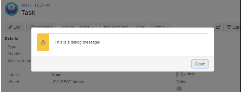

Alexandru Magiaru May 8, 2024
Hello @Kumar,
you can add a transition screen and a message box custom field on that transition screen,
where the default value in it's context can be the text you want to add.
Look at this for further tips:
