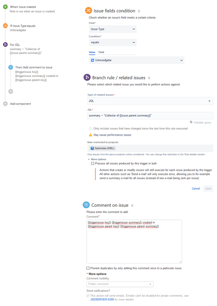

Hi @Krzysztof Kiser I did it in our playground (german Spielwiese) project and it works fine:
Florian
August 28, 2020
The equals comparator (=) is not allowed with the issue field. Use tilde (~) instead and use quotation marks around the smart value.

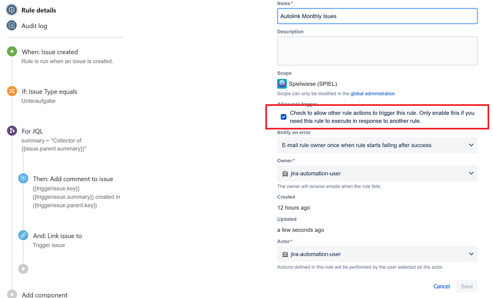

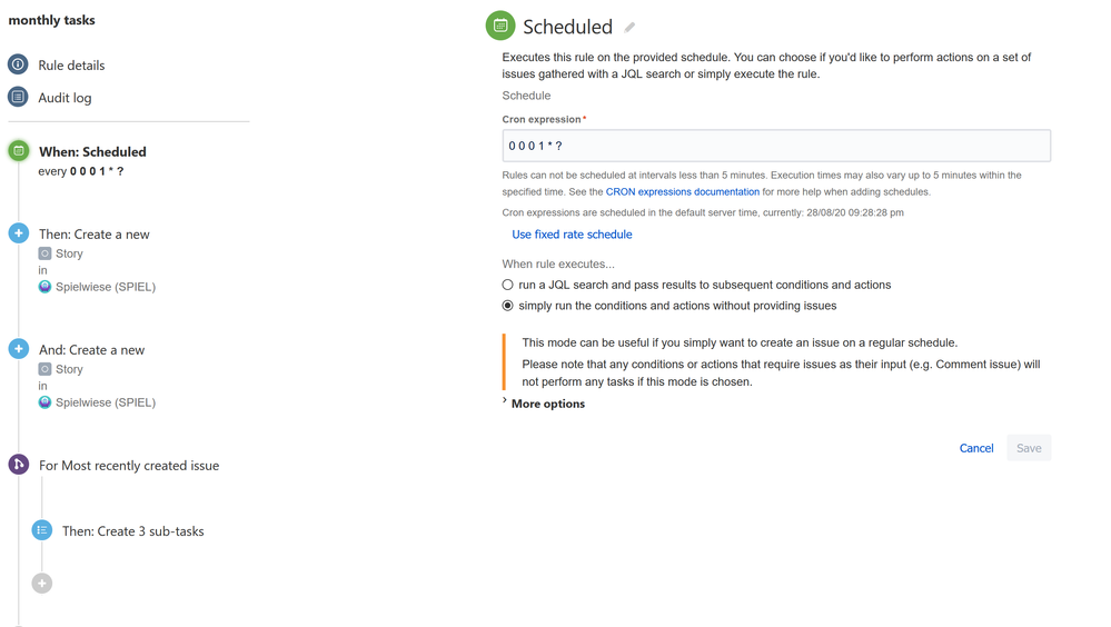

I did it!
For the first rule make sure that the checkbox shown in the picture is set:
The second automation rule sould look like this:
Done!

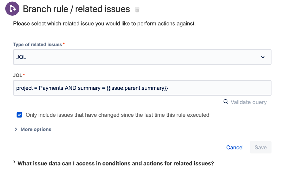

Create a rule that is triggered when a subtask is created.
Use a branch rule with JQL “project = other-project-name and summary = {{issue.parent.summary}}”
Set a link between this {{issue.key}} and {{triggerissue.key}} within the branch rule.

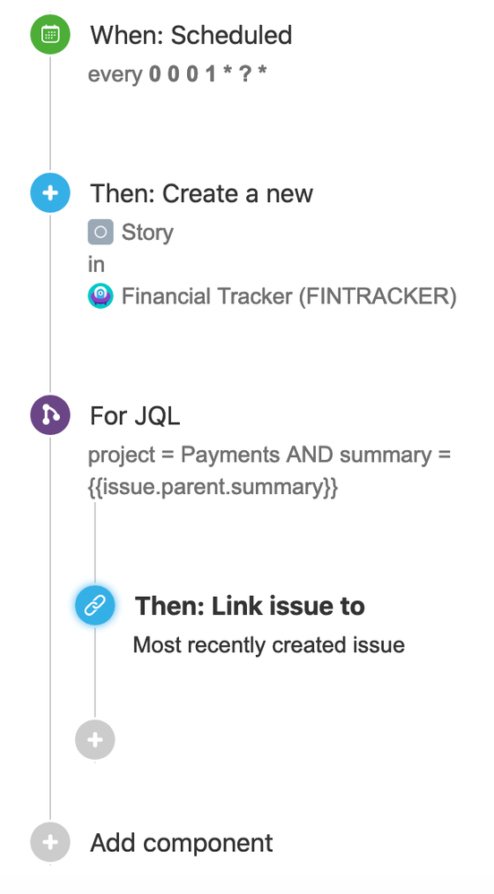

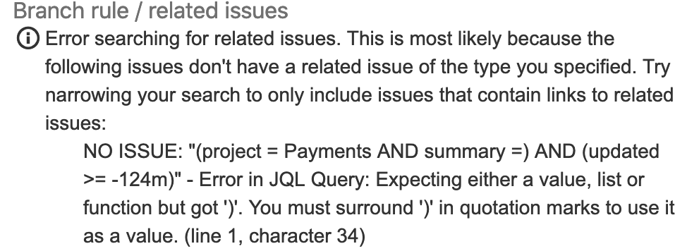

@Florian  I have tried that before, but I think JQL does not accept variables. It gives back an error.
Here's my setup, maybe I've done something wrong.
Screen Shot 2020-08-25 at 11.04.41 PM.pngScreen Shot 2020-08-25 at 11.04.53 PM.png
And here's the error:
