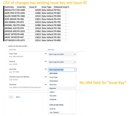

Sarah Wood
June 3, 2019
There is no "Issue Key" in the JIRA fields dropdown. See screenshot.

Ignacio Pulgar
June 3, 2019
May you try typing "Issue Key"?
Sarah Wood
June 3, 2019
Maybe I already tried that and nothing came up?
