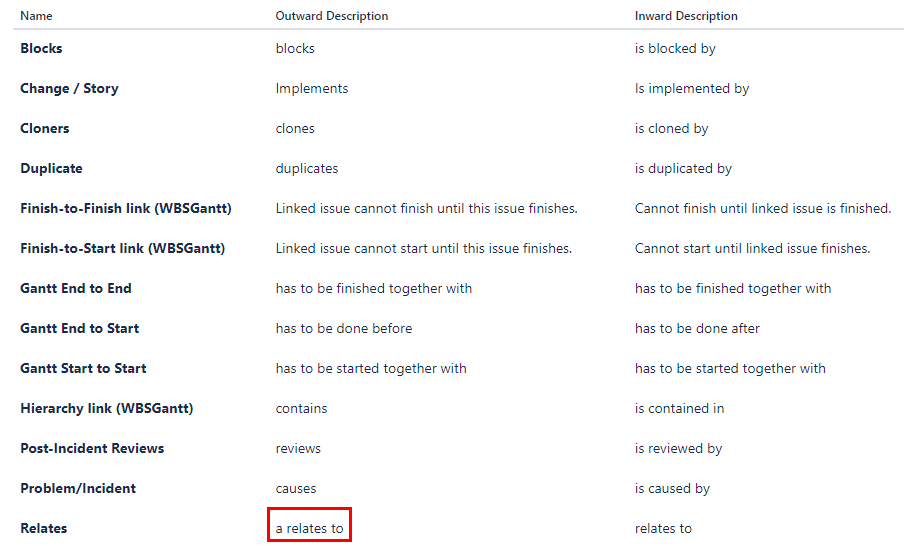

So we had this:
but would like to have the 'relates to' as default. To achieve this you must make sure the ' relates to'  is on top of the list in the setting.

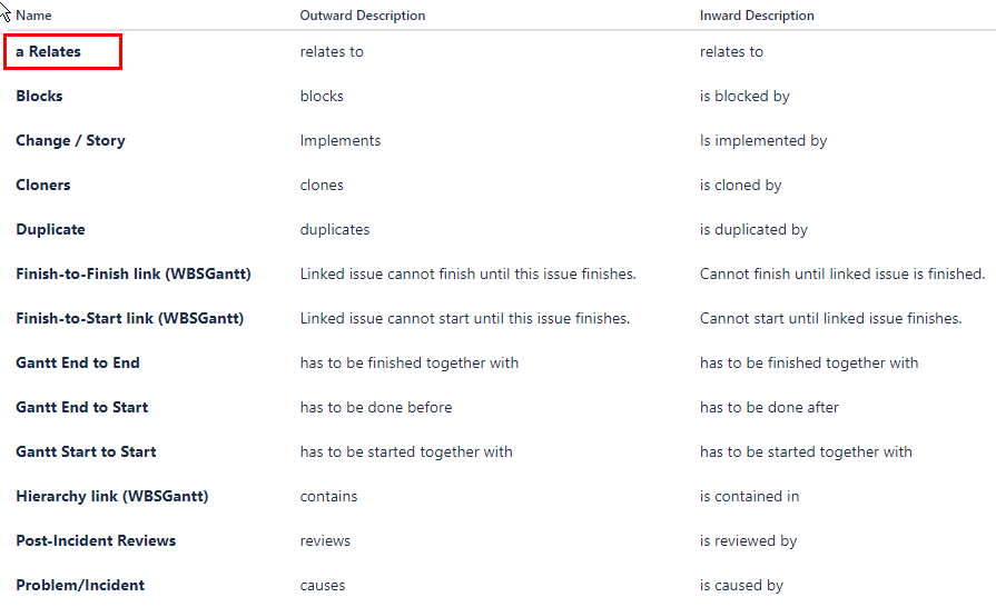

I tried changing the ' Outward Description' , 'Inward Description'  and ' Name' , but only after changing the 'Name' the 'relates to' type moved to the top of the list and made this type the default type as well. See screenshots below. Make sure you test it in a new browser session to ommit caching stuff.
Chaning the 'Outward Description'  did not move the ' relates to'  type to the top and/or to default:

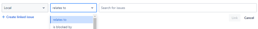

Change the Name and moved 'relates to' to the top of the list and the default value.:

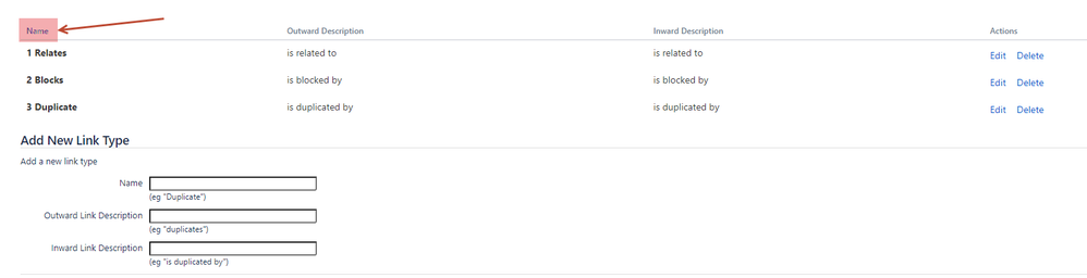

Hopefully this helps:
It appears you can achieve this by adjusting the name. The sort is based of the name value (alphabetically). What I did was edit the types and added a number series in front of the name and it sorted in numeric order. You do not necessarily need to change the values in the Outward or Inward descriptions unless you desire to. Once you go back to your issue or create a new issue the proper sort will be in place the way you designed it. For us we wanted related to the default.

To trick the system to place in the order as you wish, I placed a number in front of the name.
