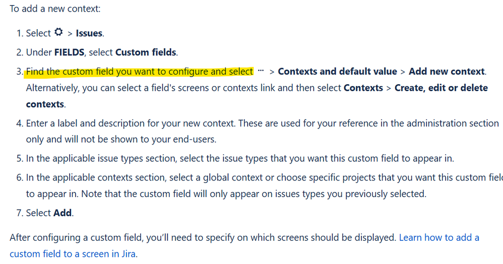

Thank you for answering to my question.
I checked the reference you gave me and understood how it works.
But, I can't find the field that i want to set a default value in the Custom Field.
The field that I want to change is "explanation".
The picture down below and yellow highlight part is where I stopped at.
Do you know if there is a limitation for field to put in these default values?
Anyway thank you !

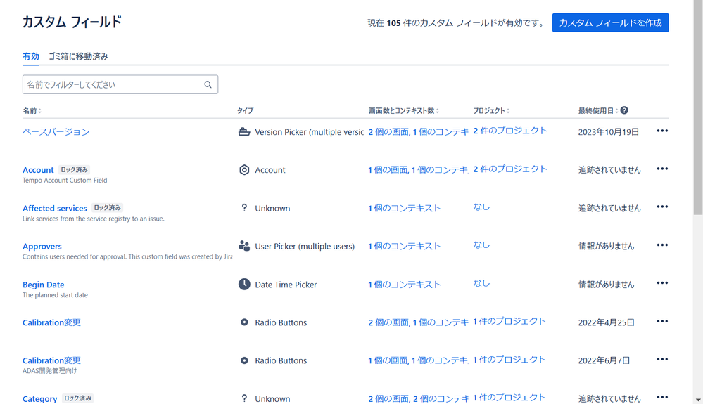

Can you provide a screen image from the Custom Fields screen showing your attempt to find the custom field?

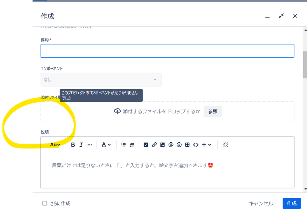

Can you also provide a screen image that shows the field in use in an issue?

2. It is written in Japanese so it might me a little tricky. But let me try to send this.
I was trying to find from here.
3.Here is the field in use.

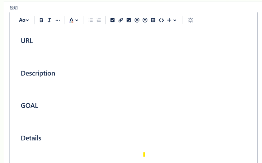

説明 can be translated to Description or Explanation.
Q. I would like to clarify a point. Are you trying to set the value in the field, or are you trying to set help text to explain how the field should be used?
-> Yes i wanted to set the value in the field.
I want this value (picture down below )to be applied for all tasks.
So that we don't need to write this every time when we create issues.
Thank you
Thank you for that additional information.
In a Company Managed project it is not possible to set a default value directly for the native field named Description.
There is a work around that involves creating a custom field, setting a default value for it, then copying the final value from the custom field to the native Description field. There are other posts in this community that have the details of that work around.
