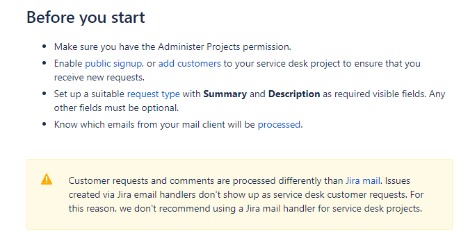

Mail Handler do not work in Jira Service Desk projects as in Jira Projects. You have to activate email requests in project settings.
https://confluence.atlassian.com/servicedeskcloud/receiving-requests-by-email-747602718.html
Please accept the answer so it can help others.

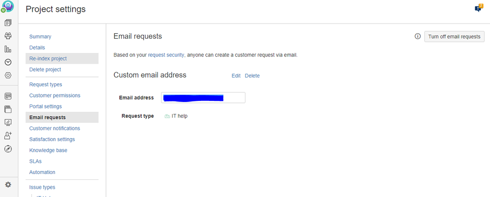

The customers can create issues via mail?
Are you using the system Mail handler and not the "Email request" in project settings? (see below)
RAMROD
November 15, 2017
No I have this feature off.
Yes using Cloud mail handler
