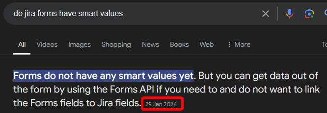

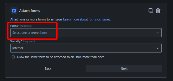

I assume you mean this field - which when I type into it it appears to just filter the options in the dropdown.
However, even if it does have the potential to accept smart values it doesn't appear you can reference forms in that way unfortunately:
Bill Sheboy
August 1, 2024
Thanks for testing that with the rule action.  And, the bot answer seems to be referring to smart values for issues, not for rule actions.
A workaround you can use is calling the REST API endpoint to add the form to the issue using the Send Web Request action.  You will need the list of the form id values for that (and storing them with a Lookup Table may help).
