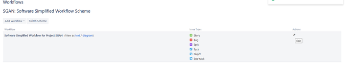

Hello @Or Go ,
As a jira administrator -
1. Goto project --> project --> project settings --> workflows
2. Click on pencil icon to edit your workflow
3. Click on workflow transition and click on "properties"
4. Now add the opsbar-sequence property key and property value as '3' for "To do" transition
5. Repeat step 3, and 4 for other transitions where you would like to change the order
6. Once you finish setting up property keys and values,  publish the workflow and come back to your issue and you can see the statuses reordered.
In my workflow I have
To Do - 3
Done - 1
In progress - 2
Fix Resolution - 0
and below is the result
Note: If you are not a jira admin, please work with your jira admin to make this change.

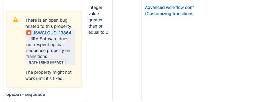

Hi Or, you used to be able to do this in the older issue view. However, in the new UI it no longer works as stated in the document you reference...
As the above snippet from the doc states JSWCLOUD-13864 has been open regarding this bug. I haven't seen much traction on this and AFAIK the problem still exists though I have not personally tried lately.

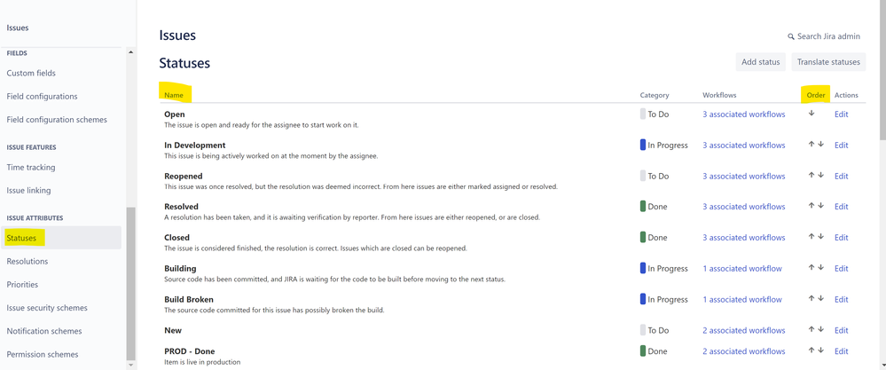

I have just confirmed today 1/27/2022 that this does not work. Seems the status dropdown list is in the order in which statuses get created. Baffling that something as simple as ordering of lists could be so complicated in a seasoned product like Jira...
I did find an Issue Statuses menu which seems to allow ordering, but does not seem to work for me. Clicking on order arrows does not do anything or even through a message.
I see this issue has been reported already with a link to vote on this!
https://community.atlassian.com/t5/Jira-Software-questions/Why-can-t-I-reorder-some-of-the-statuses-in-the-issue-gt/qaq-p/1726840
