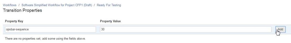

Could you show us the property for "ready for testing" on the transition?
Candace Phelps
June 19, 2017
Hi Nic,
Absolutely, here's a screenshot of the property for "ready for testing" (still called "Dev Done" in some places). Do you see any issues with this?
Ready For Testing - Property Key Value Pair.jpgThanks!
Candace
Patrick Busch
July 6, 2017
Hi,
looks like have added it to the workflow step, but you must add it to workflow transition itself
Like # people like this
Nic Brough -Adaptavist-
July 6, 2017
Patrick has it right on the nose.  All the docs say to apply properties to the transition, and that does work.
(Sorry, I didn't see the comments earlier, as Lithium's email system was broken until more recently)
Candace Phelps
July 7, 2017
Wow, thanks Patrick and Nic. This is quite tricky to find the right feature / option, but I think I've got it now. I'm recording what I did here in case anyone else is looking for this in future:
1. Navigate to the draft workflow
Jira > Issues > Workflows
2. Click on the Transition(id) to be edited
Step 2 - click on the transition to be edited.jpg3. Click View Properties for that transition
4. Add the opsbar-sequence key with the appropriate number
e.g. For the Ready For Testing transition, I added:
opsbar-sequence = 30
Step 4 - add the opsbar sequence pair.jpg5. Click Add
6. Repeat steps #2 - #5 for the other steps that need to be reordered
Note: editing a Transition that is part of one step will update the Transition everywhere it is used.
7. When you are done your edits, click Publish Draft. You will get a popup asking if you want to save a copy of the previous version.
8. Enjoy your reordered steps! :)
