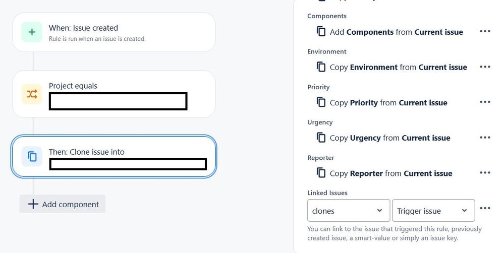

We have two projects MAFSI which is a Software development type project and AFSIM which is a Service desk type project. We have an automation rule that clones tickets from AFSIM -> MAFSI every time a new tichet is created, the tickets are linked between with clones/is cloned by:

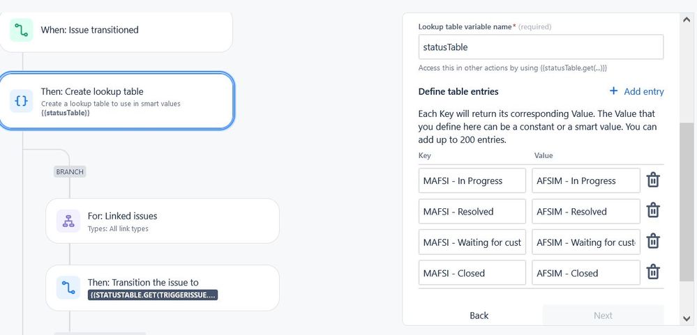

We created an automation rule to sync all available statuses between the two projects:

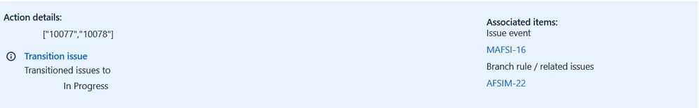

The rule runs with success when we change status Open -> In progress (from project tickets) and when changing Waiting for customer -> Open (from service desk portal):

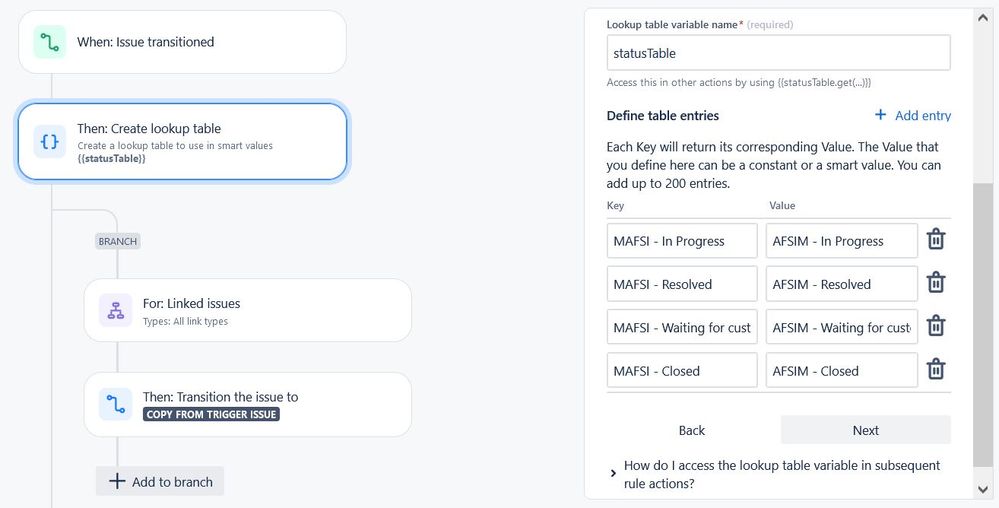

I think the fact that the transitions have worked in some cases are pure luck instead of related to the configuration of your automation rule. The way you have set up your rule right now, you are indeed not using the status mapping table you have created.
The {{statusTable.get(triggerIssue.status)}} you should fill out in the last step, where you have now selected copy from trigger issue. Instead of copying the transition, you should actually SET the value and fill in the smart value there.
On a side note: I have not used this technique in practice myself. But if you start seeing errors after you make this adjustment, make sure that the statuses in your workflow actually match with what you put in the mapping table. I would not be surprised if they are not called AFSIM - In Progress etc.

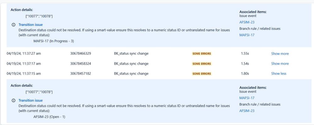

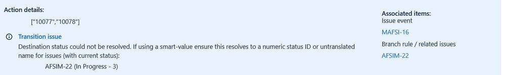

Hi @Walter Buggenhout I managed to add {{statusTable.get(triggerIssue.status)}} in the last step as you mentioned but after this change the rule does not work for any of the statuses, not even the Open -> In Progress/ Waiting for customer -> Open which worked before.
Now we are getting errors like these:
Could it be an issue that one project uses two workflows and one projects uses one workflow?

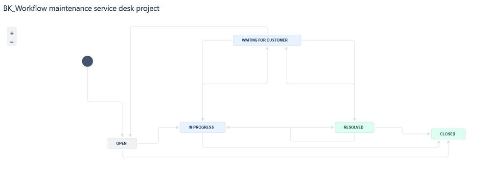

Service desk uses one workflow for all issue types (Incident, Question, Sub task)
Software project uses two workflows, Incident and Question is identical with Service desk. Sub task workflow is different.

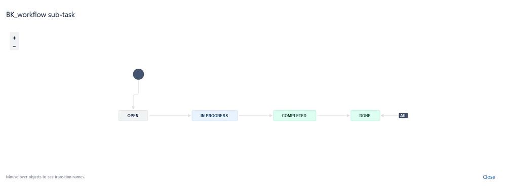

I think it's important to do 2 (or maybe even 3) things here:
  1. Ask yourself if you really need to create a software ticket for every request that comes into your service desk. While it is quite normal to use different tools for those 2 areas, I am quite sure that not every ticket that comes in really requires effort from your dev team. If it does, and you are choosing this setup for licensing reasons, then maybe you should simplify the workflow of your JSM tickets into e.g. New / With Development / Done. If certain tickets can be handled by your service team (without involvement from dev), you may want to redesign the workflow so In progress is something for your service team only and With Development may represent the handover to the software team.
  2. Consider if you really need to duplicate all transitions. In the scenarios I described under (1.), you would only need to create a software issue when you send a ticket to that team (and not automatically whenever a ticket gets created) and sync the status back from the software ticket to JSM when you complete the software ticket. That would only be 1 update, drastically simplifying your scenario.
  3. No matter what scenario you implement, the status you try to move an issue into with an automation rule, must be available from the status the issue is currently in. Looking at the subtask workflow you shared, an issue that is currently in status Open cannot be transitioned to Completed, because there is no transition between these statuses.
So, I would recommend to go back to the drawing board first to design exactly what you want to happen. Then, with that up your sleeve, implement this step by step. If you get an error, look at the issues the audit log mentions as impacted and have a close look at their current status, the status you're trying to get it into and see if that is a valid transition. That should explain a lot.
