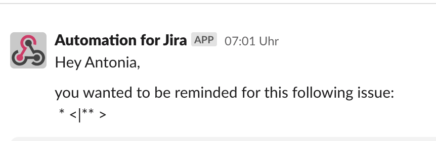

Hello Daniel!
Me again, I have done it as you mentioned.
Now I get an empty Slack message:
Any idea what might need to be changed? :)
All the best,
Vanessa
Very late in seeing this, but the smart values were not correct for the lookup list. I edited the answer above, but here is the relevant portion that needed to be updated in the Slack body:
{{#lookupIssues}}
• <{{url}}|*{{key}}* {{summary}}>
