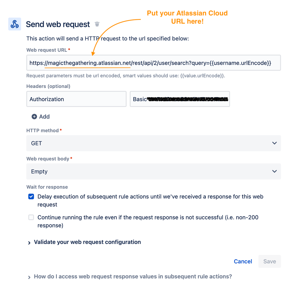

  • Set Up an Automation Rule:
    • Create an API token for the web request process. This requires base64 encoding your credentials along with the API token. For detailed instructions, see the documentation:
    • Utilize the API to submit or reopen a form using a PUT request. Example usage includes:
      • Reopening a Form:
        The request method will be PUT:
        PUT https://api.atlassian.com/jira/forms/cloud/{cloudId}/issue/{issueIdOrKey}/form/{formId}/action/reopen
        - Your Cloud ID (not Org ID) is needed. Find it in the URL by visiting https://<instance>.atlassian.net/admin/jira-service-desk/portal-only-customers.
        Information Tip: The Org ID appears as /o/ before the ID (e.g., https://admin.atlassian.com/O/<org_id>), while the Cloud ID appears as /s/ (e.g., https://admin.atlassian.com/S/<cloud_id>).
        - Use smart values like {{issue.id}} or {{issue.key}} to dynamically add the issue ID or key.
        - Access the formId using smart values such as {{issue.forms.formTemplateID}}.

Hi, It works fine with 1 form per issue.
The smart value {{issue.properties."proforma.forms".forms.uuid}} provides all uuid's in the issue separated with a comma. The web request can't handle that. Is there a smart value with only the uuid of the explicit form that's being submitted?
Cheers, Pascal

the web method is a PUT with:
https://****.atlassian.net/jira/forms/cloud/****/issue/{{issue.id}}/form/{{issue.properties."proforma.forms".forms.uuid}}/action/reopen
4. I am getting
HTTP Status 405 – Method Not Allowed
The method received in the request-line is known by the origin server but not supported by the target resource.

Bruno Altenhofen
September 20, 2023
Hey @Florin and @CentricDataProjects
Thank you for your feedback and sorry for my delay in responding here!
So, I noticed from your screenshot that you are using in the "Web request body" the value "Issue data (Jira format)" and not the option "Empty". If you guys are still experiencing the error 405, could you kindly double-check if the option in the "Web request body" is "Empty"?

André Cohen
November 2, 2023
Hi @Florin and @CentricDataProjects I actually fixed the issue now. I was using my endpoint instead of using https://api.atlassian.com/
My bad as @Bruno Altenhofen instructions were correct. Thank you, this is really great while https://jira.atlassian.com/browse/JSDCLOUD-10671 does not get implemented.
