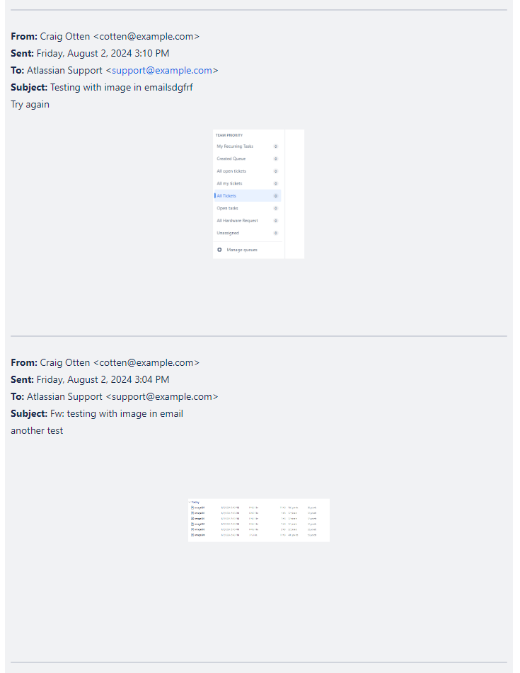

Here is an example ticket output from the setup below after the signatures were removed:

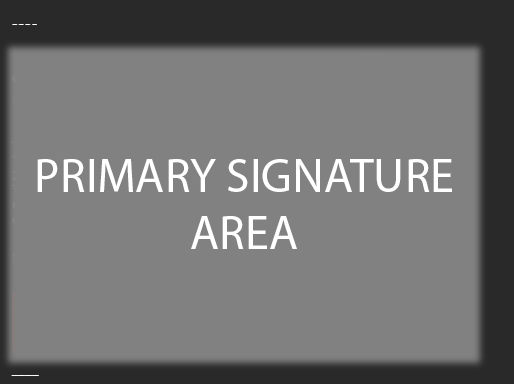

Within our organization, we use an app within Outlook that normalizes and auto-applies signatures to all our users. We are currently using Code2 to accomplish this. This allows us to use a defined template, designed by our marketing team, for all users and then pass in the user specific variables (name, email, phone, etc) for the specific user while they are drafting their email. Controlling the signatures is simple HTML code for creating the template configured in the Code2 platform.
Because of our use of this signature app, I was able to encapsulate the primary and reply signature templates with unique text strings before and after the signature. I tried to make these strings appear to be part of the signature just in case our user's noticed them. For the purposes of this example, for the start of the signature I used 4 white dashes, "----", and at the end of the signature I used 4 white underscores, "____". I made the text for these white to try and hide them from the user so they wouldn't be tempted to remove them.
Note: I got lucky with this because while the user is drafting the email, these 4 white characters don't actually appear in dark mode but they are there and after the user sends the email, they can then see them. This is the behavior I noticed on the new Outlook and Web Outlook. I'm not sure what happens on the old version of Outlook.
Example image of signature (notice the top and bottom characters before/after the signature area):
For the signature itself, that is all that was needed.

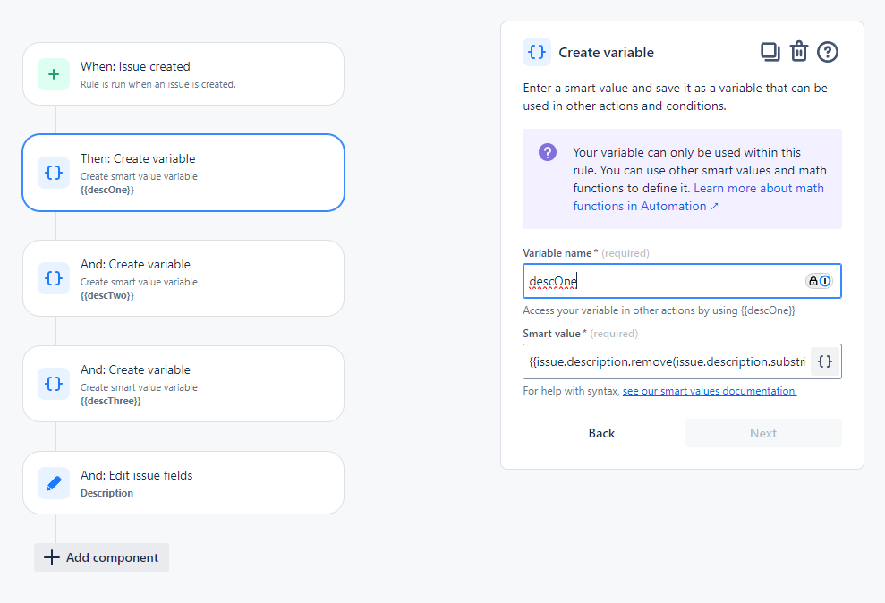

  1. When an issue is created in Jira, I first create a new variable called "descOne".
    1. For this variable, I re-work the description to remove everything after the first "{adf}" tag in the description code. This removes the primary signature that Jira autodetects.
    2. The smart value for this is as follows:
      {{issue.description.remove(issue.description.substringAfter("{adf}"))}}

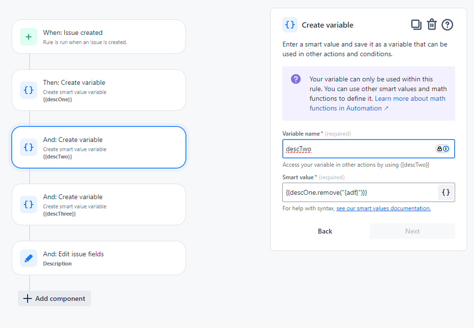

    1. For this variable, I then take the result of "descOne" and remove the remaining "{adf}" tag as one is left over from step 1. The smart value for this is as follows:
    2. {{descOne.remove("{adf}")}}

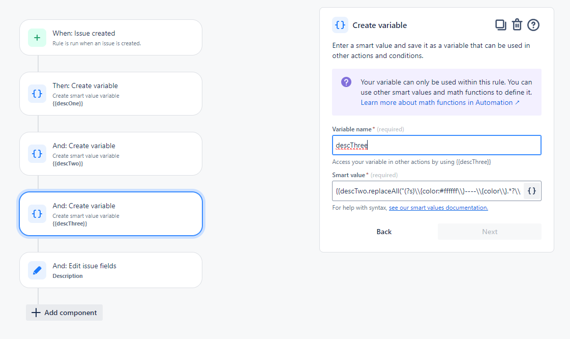

  3. For the next step, I create another variable called "descThree"
    1. This variable will take the result of "descTwo" and use the find/replaceAll command to remove anything in "descTwo" that is between and including the 4 white "----" and 4 white "____" within the ticket. The smart value for this is as follows:
    2. {{descTwo.replaceAll("(?s)\\{color:#ffffff\\}----\\{color\\}.*?\\{color:#ffffff\\}____\\{color\\}", "")}}
      1. Note: Because I am using 4 white "----" and "____" to encapsulate the signatures, I am able to target remove not only the characters themselves but also the color of them too. I'm doing this to limit the risk of removing things not within the signature.

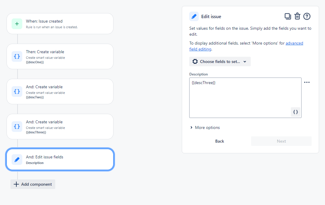

  4. I then assign "descThree" as the issue's new description and should be all set.
    1. Depending on how you setup your signatures, you may need to change step 3 to target your configuration accordingly.

Variable 1: descOne setup
Variable 2: descTwo setup
Variable 3: descThree setup
Last step: Assign the result to desc
