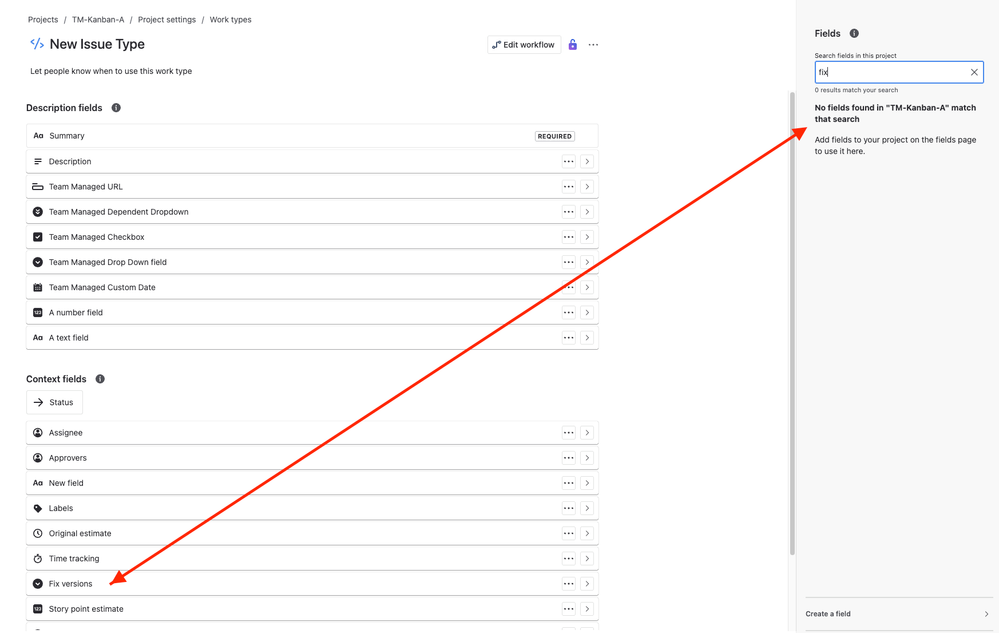

What exactly do you mean by "can't"?
Are you not able to find the field when you search for it? If so, have you confirmed that it is not already added to that issue type?
If you do find the field when searching, are you having trouble dragging and dropping it into the layout for that issue type?
If you are successful in dropping the field in the layout, then are you encountering some error trying to save the change?

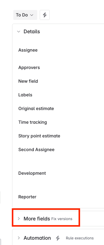

Or is the issue that the field is already present, but is hidden when empty and appearing in the More Fields section under the Details panel for the issues?

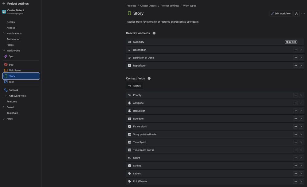

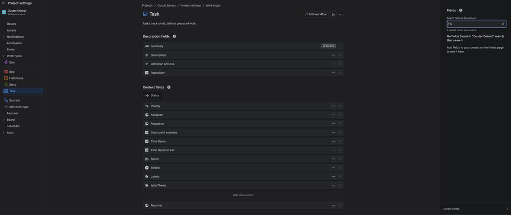

Clark Holdham
July 24, 2025
It's not listed as a field in the issue or in the right hand column.
It is however listed on other issue types

Try disabling the Releases feature for the project, then re-enabling it. That should add the Fix Version field back to the work item type layout.
