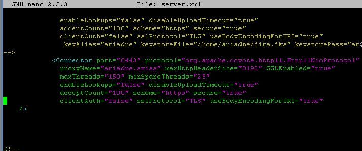

Dear @KellyW
Thanks for your reply
Please find the below screenshot
When I access HTTPS
I am getting
This site can’t be reached
Please advise me
Many Thanks
IT-Admin
KellyW
March 7, 2018
Hi Shirish,
JIRA application sits behind a reverse proxy may not know the URL scheme, hostname or port to connect to Tomcat.
Please ensure that the server can resolve the hostname 'ariadne.swiss'.
Regards,
Kelly
Vickey Palzor Lepcha
March 7, 2018
Are your ProxyPass  and  ProxyPassReverse configured well to point to AJP Host and Port ?
March 7, 2018
These should be mentioned in your SSL Config file - corresponding to what is on your server.xml file.
