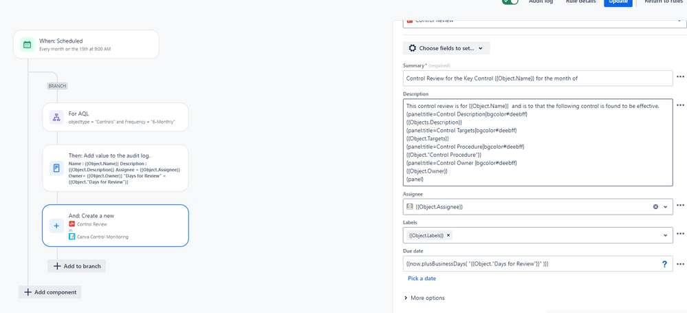

Mark Higgins
April 15, 2024
Hi @John Funk
Thanks for responding, and I hope you can see this.
I was thinking variable as well.

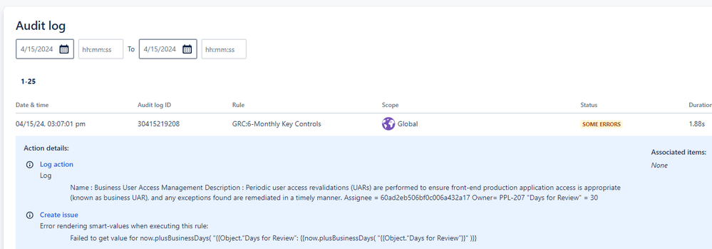

THe audit log shows that the Days for Review is 30, so I'm not sure where its going awry.
Thanks for responding.
Cheers
Mark
John Funk
April 15, 2024
Thanks for sharing! I am thinking maybe it's the double quotes on the outside of the outside part. You wouldn't use those with a variable so probably not here either.
Maybe take those off and try again. The inside ones should be good because that's what is used when the log returns a value.

Did you notice there are curly quotation marks (i.e. smart quotes) in the expression rather than the generic, straight ones?  I do not believe the curly ones are supported in smart value expressions.

The three possible reasons it did not with the other syntax are: the extra / incorrect quotation marks, the extra spaces in the expression, or for the Object it did not resolve inside the function.
One way to check stuff like this is to write it, piece by piece, to the audit log to check progress.  When it works (or stops working) the cause is revealed.
