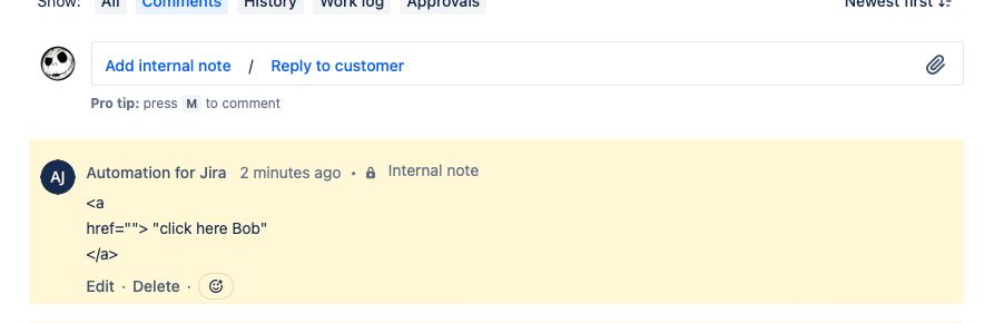

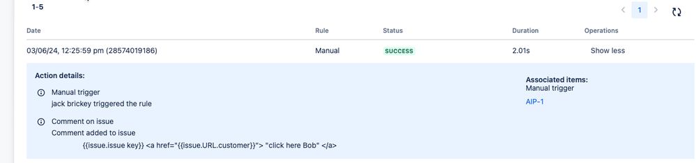

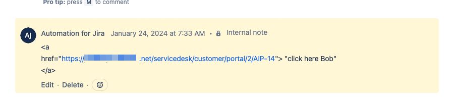

hmmm, something does appear to be amiss. I just looked at an old rule that I had and it does not appear to be working as previous. Here are the results below
last week here was the result...
I wonder if this is a side effect of the automation issues earlier this week.
Jack Brickey
March 6, 2024
@Marius Fischer , So I spoke too soon. I just ran several more tests and it appears to be working. I haven't yet figured out why it's not working on the one issue I tested it on but I'm sure it's something I'm just overlooking. Would you mind sharing a screenshot of your automation rule?

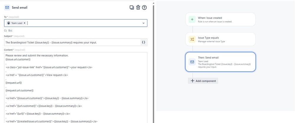

at the moment it's a mess because i'm testing different options:JSM_url1.jpg

Bill Sheboy
March 6, 2024
Hi @Marius Fischer
Looking at the image you posted...
The smart value {{createdIssue}} refers to the last issue created during the rule execution: https://support.atlassian.com/cloud-automation/docs/jira-smart-values-issues/#--createdIssue--
Please try changing that to just {{issue}}

Marius Fischer
March 6, 2024
Thank you @Bill Sheboy and @Jack Brickey for your time and effort!
Above you can see the solution being in me having too many Automations running at the same time.
