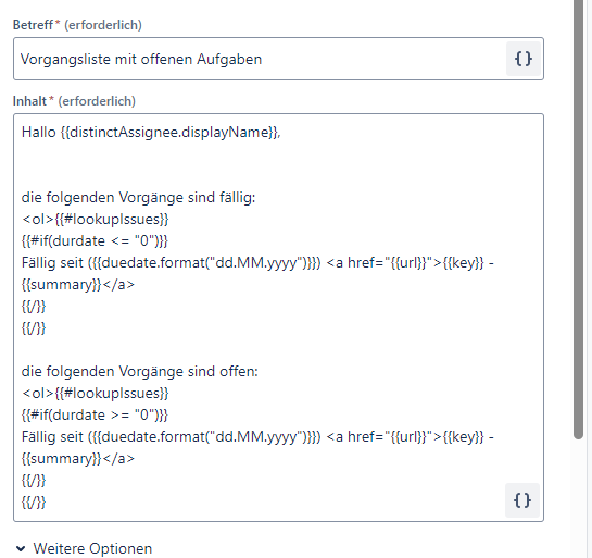

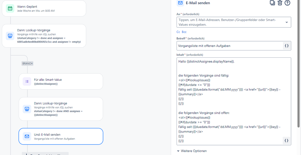

in einer Automation zwei Listen in einer E-Mail, einer {{#lookupIssues}}
Kristina Galwas
October 8, 2024
Ist es möglich mit der {{ #if( Bedingung in einer Automation nach dem Fälligkeitsdatum zu filtern?
Folgendes habe ich ausprobiert, leider werden damit die Listen leer.

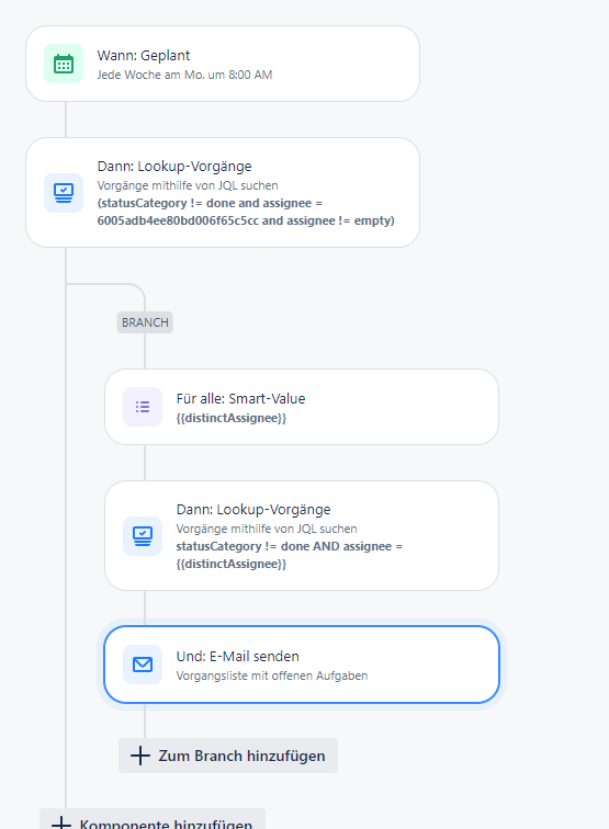

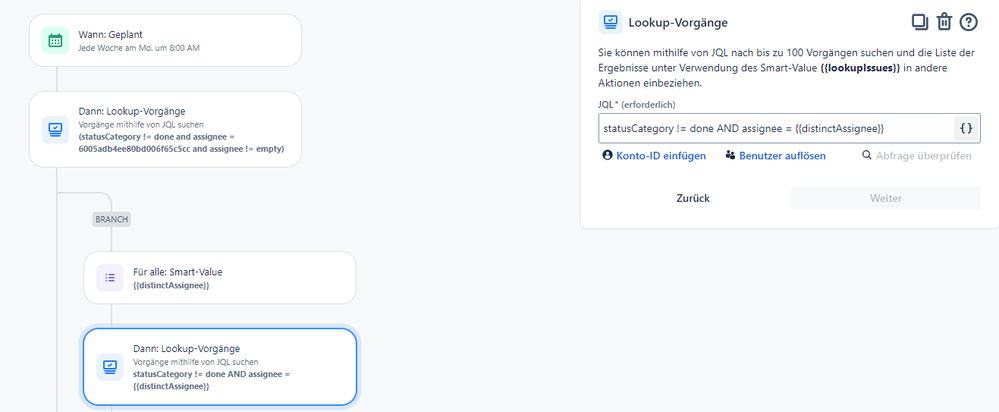

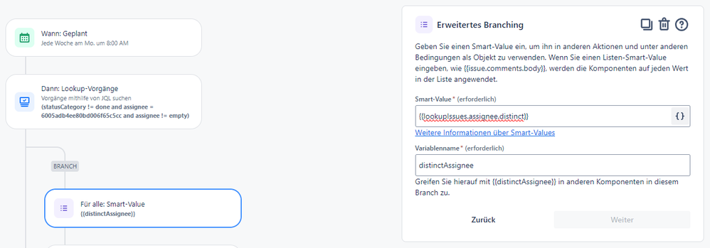

Hi @Kristina Galwas
Can you provide a screenshot of the configuration of the branch action.
Is see you have set the variable as new {{distinctAssignee}}
I wold also urge to have a log action before the lookup to see what the values are for the variable {{distinctAssignee}}
Kristina Galwas
October 9, 2024
Hi @Marc -Devoteam-
I will gladly send you a screenshot
Screenshot 2024-10-09 135928.pngScreenshot 2024-10-09 140124.pngScreenshot 2024-10-09 140156.png

HI @Kristina Galwas
If you place a log action before the lookup in the branch to see what the values are for the variable {{distinctAssignee}}.
Is there any result, when running the rule?

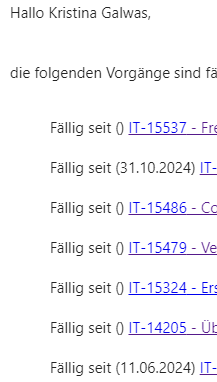

Hi @Marc -Devoteam-
I only get a result in a list if I remove the if ({{#if(durdate <= “0”)}} function.
the result when I remove the IF function looks like this:

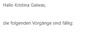

with IF function I get the following result: (the list remains empty)

Hi @Kristina Galwas
What kind of field type is "durdate"?
Is this a date field, number field or else?
Kristina Galwas
October 9, 2024
Hi @Marc -Devoteam-
It is the due date - i.e. a date field.
I just saw that I have a typo in it, but even if I write duedate, I have the same behavior.
Marc -Devoteam-
October 9, 2024
Hi @Kristina Galwas
As it's a dat field you can't compare it with a number. You can only compare to a date.
So {{#if(durdate <= “0”)}} won't work, the "0" needs to be replaced with a date.

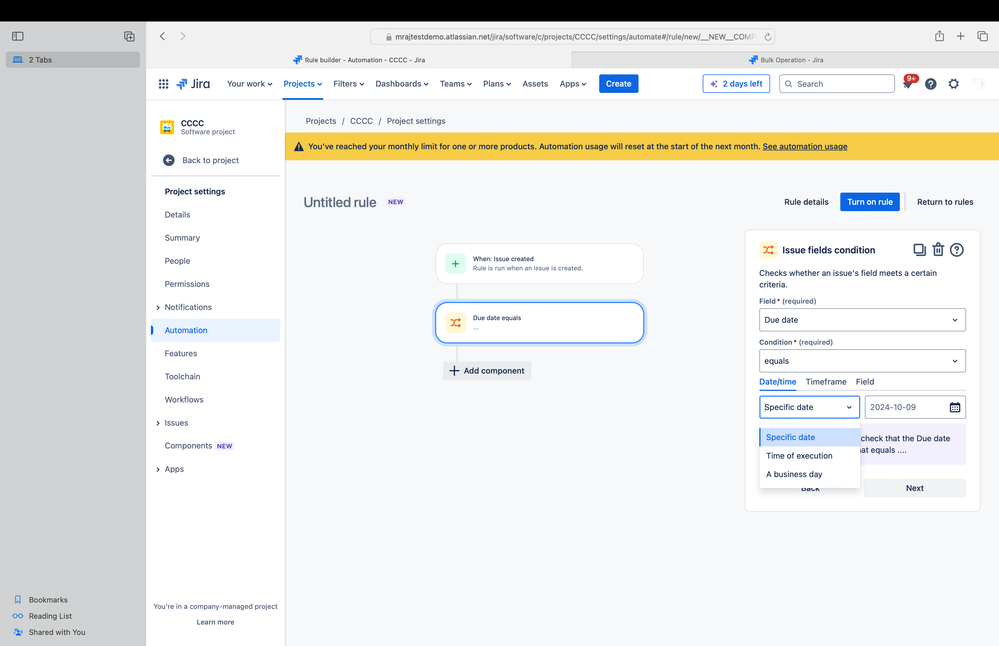

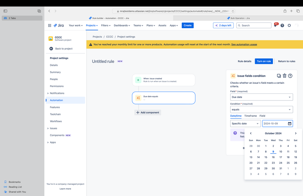

Mohanraj Thangamuthu
October 8, 2024
Hello, Good day. You could try the following condition.
Screenshot 2024-10-09 at 11.30.38 AM.pngScreenshot 2024-10-09 at 11.30.45 AM.pngScreenshot 2024-10-09 at 11.30.53 AM.png
