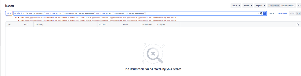

Hi @Humashankar VJ
Thank you for your response. I tried the workaround you suggested, but it didn’t work and threw an error. Please find the details attached.Screenshot 2024-10-28 172231.png

@Sachin Guttala
Can you update the format from - yyyy-MM-dd to yyyy/MM/dd and give a try.

Sachin Guttala
October 28, 2024
Hi @Humashankar VJ tried that also but not working.

Humashankar VJ
October 28, 2024
@Sachin Guttala
Try this and it worked at my end as i converted the time zone to UTC- Update your Project name alone from the JQL:
JQL:
Project = "Support" AND created >= "2024-10-28 07:00" AND created <= "2024-10-28 16:00"

Sachin Guttala
October 28, 2024
Hi @Humashankar VJ
The workaround worked, but we need to update the date manually every day.
