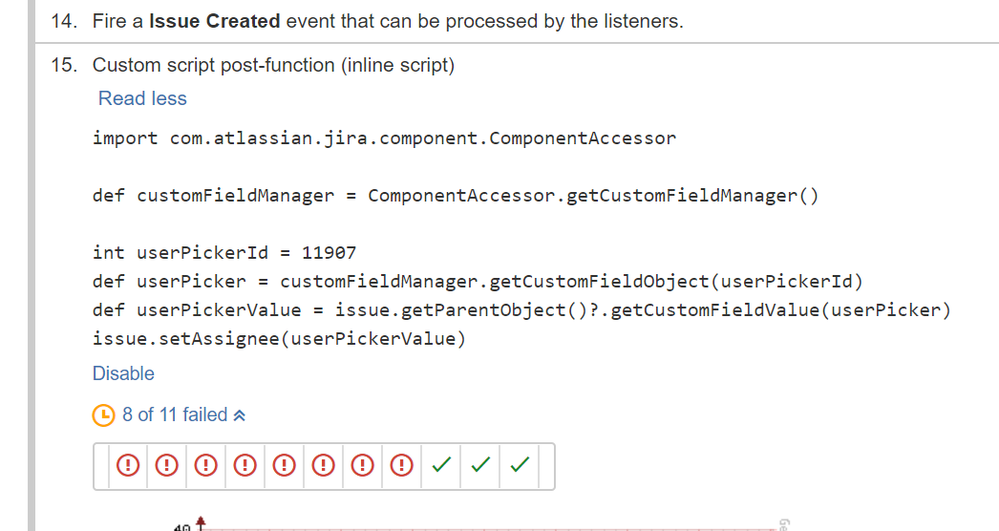

this creates subtask my question of how can I add an assignee automatically from a custom field(user picker) value from parent. which code should I add? I tried some but failing to pull assignee from the custom field(user picker). please help @Antoine Berry @Tarun Sapra @

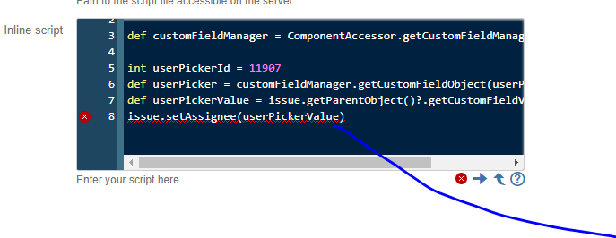

Hi @Surender Reddy ,
Please save as is. It is showing an error because the groovy console is not detecting userPickerValue as an ApplicationUser object, but at execution time it will work.

import com.atlassian.jira.component.ComponentAccessor
def customFieldManager = ComponentAccessor.getCustomFieldManager()
int userPickerId = 12803
def userPicker = customFieldManager.getCustomFieldObject(userPickerId)
def userPickerValue = issue.getParentObject()?.getCustomFieldValue(userPicker)
issue.setAssignee(userPickerValue)
and the error for this code is

Still, there is an error showing, the transition is getting successful but post function is failing.
Time (on server): Mon Jun 03 2019 11:45:49 GMT-0400 (Eastern Daylight Time)
The following log information was produced by this execution. Use statements like:log.info("...") to record logging information.
2019-06-03 11:45:49,954 ERROR [workflow.ScriptWorkflowFunction]: parent issue : EAP-436 2019-06-03 11:45:49,954 ERROR [workflow.ScriptWorkflowFunction]: user picker : null 2019-06-03 11:45:49,956 ERROR [workflow.ScriptWorkflowFunction]: ************************************************************************************* 2019-06-03 11:45:49,956 ERROR [workflow.ScriptWorkflowFunction]: Script function failed on issue: EAP-465, actionId: 1, file: <inline script> java.lang.NullPointerException at com.atlassian.jira.issue.IssueImpl.getCustomFieldValue(IssueImpl.java:896) at com.atlassian.jira.issue.Issue$getCustomFieldValue$4.call(Unknown Source) at Script115.run(Script115.groovy:9)
See, user picker is null, is 12803 the correct ID ? You mentioned 11907 before.
yaa sorry I was changing the code from few days so forgot that and the post function is successful now, no logs found. but the problem is the assignee of the subtask is still unassigned.
