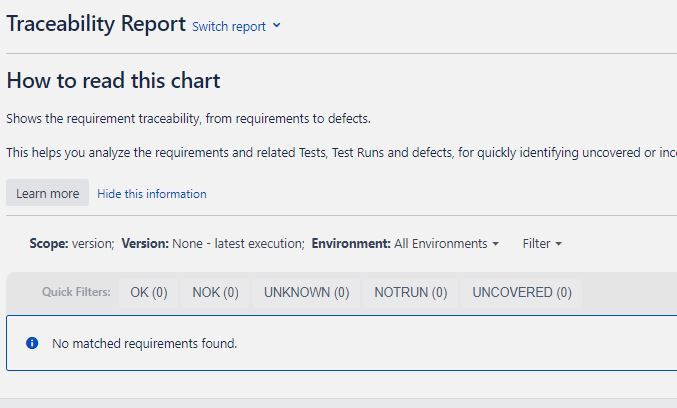

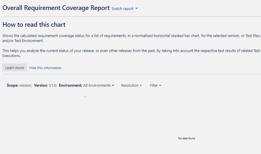

For Xray Reports:  when trying to generate Requirement Coverage & Traceability Report - no data is Returned.
See following screenshots :TraceabilityReport.JPG

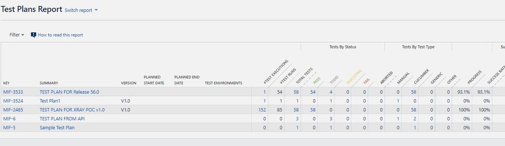

However Test Plan Report is generated Successfully
See Screenshot :

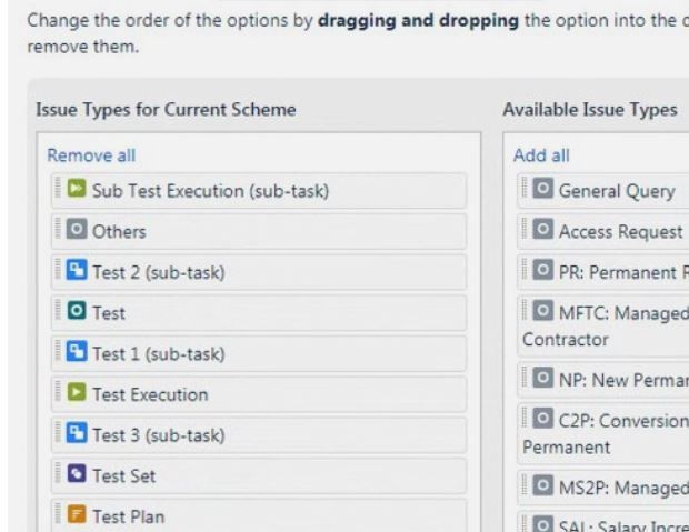

However in the issue type mapping, I see "Requirement Issue Types" has not been mapped as per: https://confluence.xpand-it.com/display/public/XRAY/Issue+Type+Mapping
Can you advise if this is an issue ? Does "Requirement Issue Types" need to be created to generate the report ?

This issue is now resolved.
The problem was with IssueType Mapping being incorrect.
Fixed the Issue Mapping as per: https://confluence.xpand-it.com/display/public/XRAY/Issue+Type+Mapping
And the Reports now work.

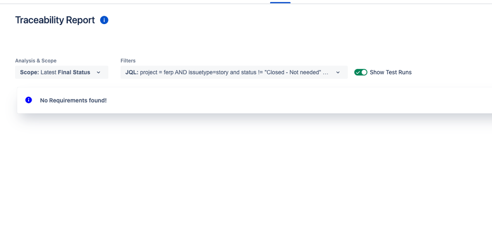

I am having a smilier problem. I have checked the coverage fields etc.
There are meant to be 724 results returned using a JQL. But when the traceability report is generated we get "No requirements found." Have done everything I could to trouble shoot this. Note we are using the cloud version.
