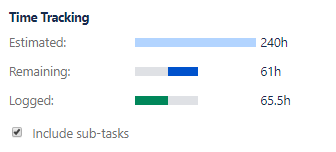

Hi, I logged 120hs as Original Estimated for a Story, then created the sub-tasks inside and logged the Original Estimated for each of them (120hs total for subtasks).
The problem is that now I got 240hs as Original Estimated (for the Story = Story + Subtasks).
Is there any way I can either set the Original Estimated of the Story = 0 (edit it) or maybe delete it just letting there the ones for the different subtasks (that all together sum up = 120hs) ?

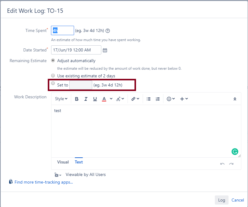

Hello @Ricardo Salatino
First, you need edit worklog permission to edit own worklogs, you can request this permission from your admin if you don't have it, or someone with the required permission can do it for you.
Permission required Edit own worklogs
Editing a work log entry
  1. Navigate to the issue and view its details.
  2. Locate the Activity section and select the Work Log tab.
  3. Locate the work log entry you wish to edit.
  4. Click the Edit (pencil) icon, located at the right of the work log entry.
  5. The Edit Work Log screen is displayed.
  6. Edit the fields Remaining estimate to the desired time
BR, Olga

The issue here is that I do not want to edit the Remaining Estimate, else the Original Estimate (which is the one I wrongly entered).
By editing the Remaining Estimate, the Original Estimate will remains 240hs (instead of the 120hs I just want).
So, is there any way to edit (set to 0) or just remove the Original Estimate if I entered it wrongly (if the initial estimation set in the Original Estimate is wrong) ?
