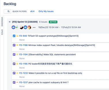

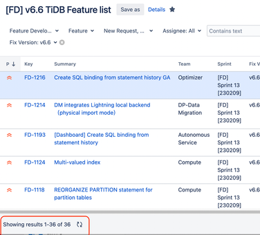

I set 35 backlogs in one active sprint. But I can't see them in the backlog board. I can see them in the filter.

Cira Zhao
January 5, 2023
All the issues are assigned to this sprint and the sprint has been started (active). All the issues are in in-progress status.

Cira Zhao
January 5, 2023
Even in the scrum board, I can't see all the backlogs.
