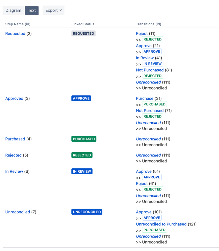

So far I have not found a documentation reference that explains the italicized "Unreconciled" Transition text.

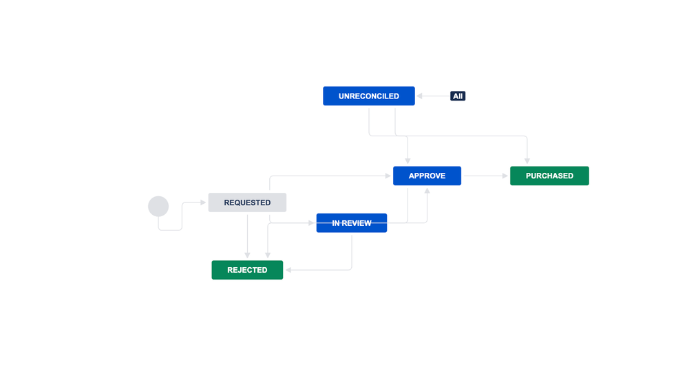

Can you provide an image of the workflow diagram, please?
What had you added to the workflow before the bulk change? And what appeared to get added to the workflow when you executed the bulk change?

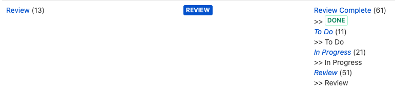

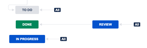

Looking at my own workflows, it appears that a transition displays in the Text screen in italicized text when that is a transition supported by a Global transitions (an "All -> " transition).
Looking at the transitions in my workflow that can be made when an issue is in the Review status.
Screen Shot 2022-10-24 at 12.27.54 PM.pngScreen Shot 2022-10-24 at 12.28.22 PM.png
From Review I can transition to To Do, In Progress, and Review based on Global transitions. I can transition to Done based on a specific transition. The transitions that are global show in the list as italicized.
That suggests that the transition to the Unreconciled status in your workflow can be made from any other Status in the workflow through a global transition.

Action 1: Add new step into workflow
Project Settings > Workflow > Add new step name "Unreconciled" + Status = In Progress > Publish new drafted workflow (validated by checking to see that the column showed up in the board. Success!)
Action 2: Add transitions to steps to accommodate for new step/status "Unreconciled" [Note this was undone as we reverted back to an old workflow while trying to diagnose and correct the issues we've run into]
Project Settings > Workflow >add transition "Unreconciled" to all other status/steps > Publish workflow changes
Action 3: Update transition name from "Unreconciled" to "Archive_Unreconciled"
Project Settings > Workflow > Edit > Change name > Save > Publish workflow
Action 4: Bulk tag current status and transition old/stale issues to new "Unreconciled" status
Project Board Menu "Issues"> Filter "Purchased" > Filter "More...Created Date...Between - Dec 2018 and Dec 31 2021" > upper right hand corner "... - bulk change" > select issues > next > edit > add label Purchased and change assignee to unassigned" > confirm > wait for changes > Done
Project Board Menu "Issues"> Filter "Purchased" > Filter "More...Created Date...Between - Dec 2018 and Dec 31 2021" > upper right hand corner "... - bulk change" > select issues > next > transition > select "Unreconciled" > confirm > wait for changes > Done

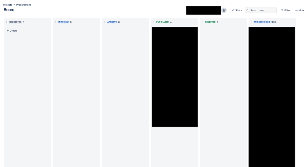

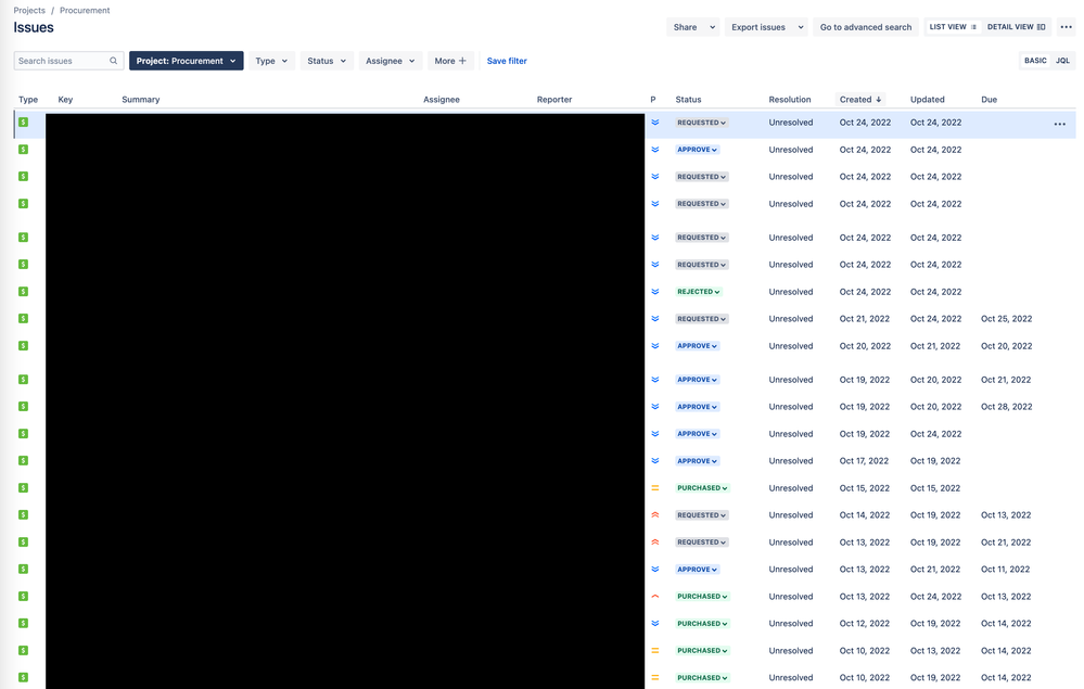

Now issues that were not bulk moved to "unreconciled" aren't showing up on the board, but they are showing in the issues view.  And newly created issues are not showing on board at all, but are showing in issues view.

When you state "Global Transition" - what does that mean?  That all status/steps can move into that state (i.e. the "all" that is pointing into the "Unreconciled"

A Global Transition is a transition that indicates an issue in any status in the workflow can transition to the specified status. In the Diagram view this is represented by an arrow pointing from All to a Status.
In the Text view it is represented by italicized text in the Transition column for the name of the transition.

You said there are issues in the "issues view" that are not showing up in the board. When you say "issues view" are you talking about the Issues option in the navigation pane on the left, or the List option, or are you talking about the issue searching functionality you can get to through the Filters menu?
Can you show us the board, and the "issues view"? Black out confidential data. I just want to see the statuses mapped to the board columns, and statuses shown for issues in the issues view, particularly for issues that are in the issues view but not on the board.

Thanks again for all your guidance and feedback. We're using a single workflow for all all issues and the only issue type is Order.  Screenshots below.
I also learned something new from Atlassian support:
Please see that in Jira Work Management, you can only see 1000 issues in the board. Checking "Unreconciled" column, I see that this limit was already reached, so you is expected you not be able to see more issues in the board.....I'm trying to figure out the logic that is used to determine which 1,000 will show.  It's not based on create date from what I can tell.
