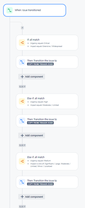

I am trying to set it where Priority is automatically assigned to tickets. However, I my automation keeps failing and tickets are getting assigned as "Critical" Priority. I've tried it two different ways. I'll show both. This is my first rule:  first_rule.png

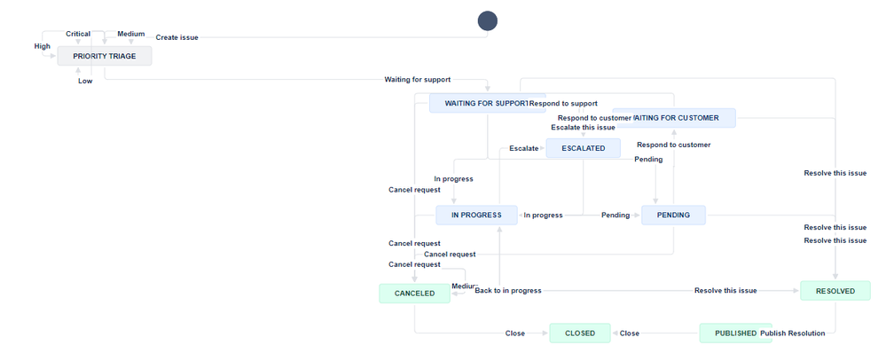

This is the corresponding workflow:

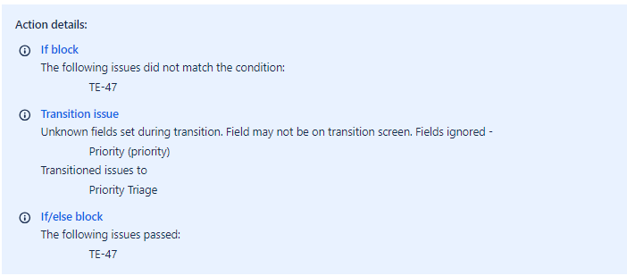

and This is the audit log error messages:

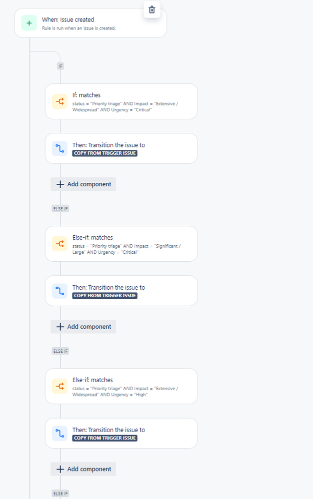

The second way I tried was by using JQL and that doesn't seem to be getting me anywhere either. here is the rule for that (its long, so this is just a portion):
The workflow for this one is the same as the first workflow provided.

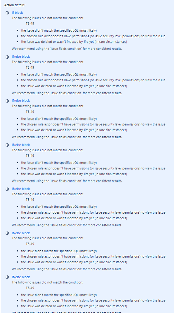

This is the audit log error i am getting for this one:

You could make your automation rule a lot simpler by just editing your issue and setting the value of the priority field to the desired outcome. If the urgency = critical and impact = widespread, I would assume you want to set the priority to the highest possible value. I would just do this by editing your issue and setting priority accordingly.
You have done a lot of work to set up all these transitions, but this is unnecessarily complex. If you really want to do it this way, the error message suggests that you haven't added a screen to your transition(s) with the priority field on it. That is necessary if you want to fill out a value there.
And, apart from that, make sure that the criteria you specify for urgency and impact are absolutely 100% correct.

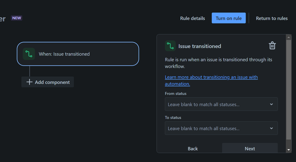

In the first rule which you sent, when setting the trigger, you should also select the status from 'Status' to 'To status,' as shown in the screenshot below.
Please try this and let me know if this works.
