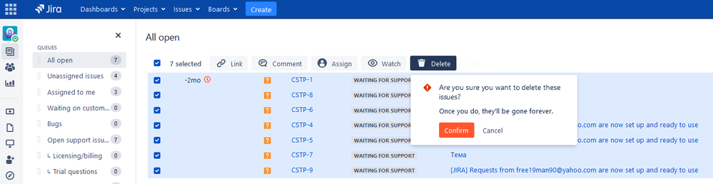

When I'm trying to delete issues from JSD:
2020-10-23_12-17-49.pngJIRA says:
but all the issues remain and won't get deleted.
What might be the problem?

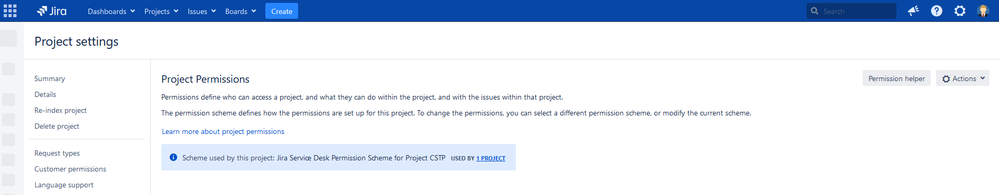

@Jack Brickey  My project permission scheme is somehow empty. Why is that so?
2020-10-23_16-11-29.pngAlso when I press the Permission helper button JIRA freezes and nothing happens.

i wish I had a server instance to give you a more direct answer. It appears that you do have a scheme associated w/ the project as it is called out in the blue highlighted text. I found this article that may/may not be of any value to you - https://confluence.atlassian.com/adminjiraserver073/managing-project-permissions-861253293.html
That said can you click the COG > issues > permission schemes and see if you find that scheme listed there and are able to edit/configure?

That said can you click the COG > issues > permission schemes and see if you find that scheme listed there and are able to edit/configure? - It is listed there:
2020-10-23_17-42-24.pngbut when I go to the scheme's permissions all I can see is the empty screen:
