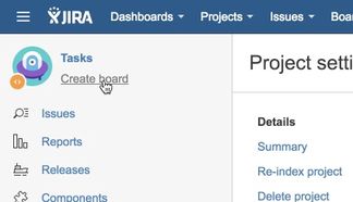

Glad to help. Once you convert to 'Software' project, you should see a "Create board" link up near the project name:
If you use this method, it puts a link to the board at the top of the list. Saves users having to use the 'Boards' menu:
Hope this works for you.

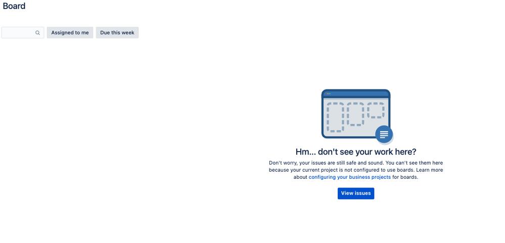

This function is rather frustrating, especially when your default Board does not even work and you need to create custom ones in the sidebar (https://community.atlassian.com/t5/Jira-Core-Server-questions/Can-you-configure-boards-for-business-projects/qaq-p/737848).
