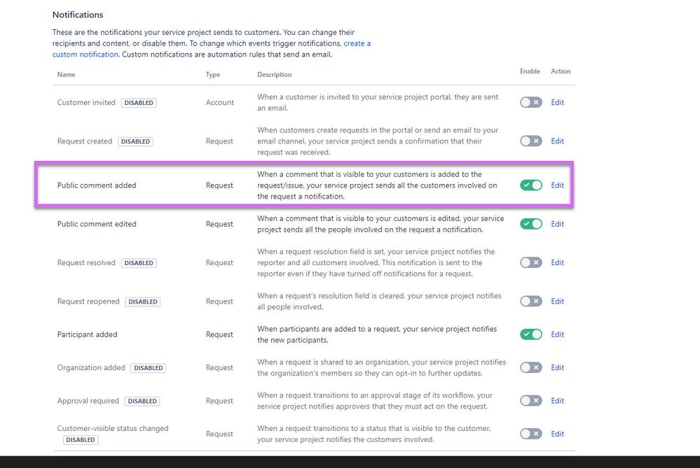

Hello,
I've found that in one of our projects, customer notifications are not sent out if there is not a request type filled in on the issue.
As to why there would not be a request type, this happens when users create an issue using this create button:
I'm not sure if this is by design, or if there is a server processing error that occurs if there is no request type on the issue. We have customer notifications turned on in the project, so I am under the assumption that the notification should be sent out regardless of how the issue was created.
Any help on this would be appreciated
Thanks!

In this case we're using the Create button to create an issue on the behalf of a customer, in which they're added as the reporter. When we experience the issue of no notifications being sent out, it's not being sent to the reporter nor any request participants added until we manually add a request type.
It just comes off to me that it shouldn't be assumed that a task wouldn't need to send out notifications just because it doesn't have a request type. Our customer notification settings should take precedence. That being said, I think this may have something to do with it: https://community.atlassian.com/t5/Jira-Service-Management-articles/Improving-the-Create-Issue-Experience-in-Jira-Service-Management/ba-p/2071476/page/2
