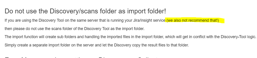

We are evaluating insight and we were going to install it in the Jira server but in the documentations says they do not recomend installing the discovery tool in the same server as jira and Insight.
https://documentation.riada.se/insight-discovery/latest/discovery-documentation/recommended-information
Why? Where should it be installed?

laralg
October 1, 2018
Hi Dave,
image.pngThis is the parragraf I was talking about, intalling insight as an add-on practiacally does nothing, the importatn part is setting up the discovery part in the server, that what I was asking..
