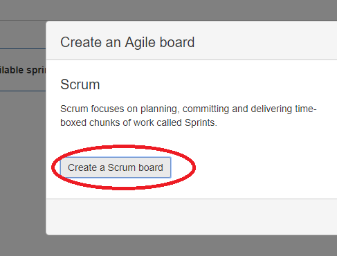

When creating a board, select "Create a Scrum board", you can define the scope of your board to either a project or a filer. Then in Backlog view of your board, you will be able to create Sprint and drag items to the Sprint box, and view the Burndown chart in the Report section.
If you have seen the Sprint and Burndown before in the same server, your should have a valid Jira Software license. Please try the above steps, and good to share a screen short of what you saw if it still not work.

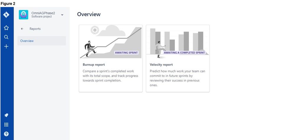

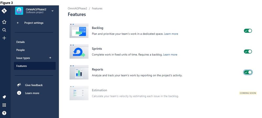

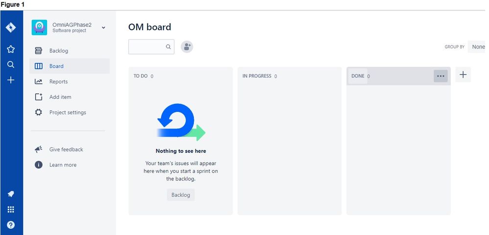

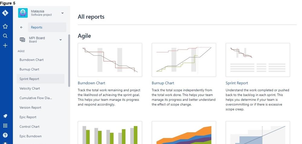

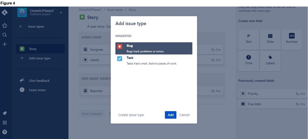

After all, I delete the earlier Project which I had created and re-create another new Project. Then, following some are the defaulted screens shown on the screen. I just couldn't find any "Scrum Board" template and neither Burn Down Chart Report from the our Jira Project. However, I can see other user have those very useful Burn Down Reports and other type of report templates (see Figure 5).
Was it due to my Jira user rights which resulted me couldn't see the best feature from JIRA? :P
