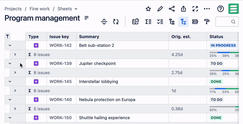

Just to expand on the last point, this is how this would look in the app that my team and I are working on, JXL for Jira:
For context, JXL is a full-fledged spreadsheet/table view for your issues that allows viewing, inline-editing, sorting, and filtering by all your issue fields, much like you’d do in e.g. Excel or Google Sheets. It also comes with a number of advanced features, including support for (configurable) issue hierarchies, issue grouping by any issue field(s), sum-ups, or conditional formatting. With these, a view like the one above can be created in just a couple of clicks.
