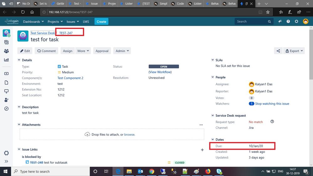

I have applied the validation in due date field at the time of issue created event.
Logic:
When the ticket<task issue type> is created and due-Date is set to 10th January 2019. Then  Due Date <sub-task issue type> should be smaller than Due-Date<task issue type>
The validation rule is working fine at the time of creating the sub-task issue created event.
The condition is provided below :
if(issue.parentObject.dueDate >= issue.dueDate )
issue.dueDate
But the validation is not working at the time of issue update event.
Also I am unable to apply the validation in due date field at the time of issue update event.
Can anyone help me where and how to apply validation in issue update event. So that the validation will be working fine for issue update event.

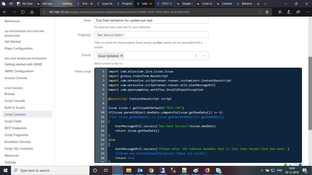

Thank you so much for sharing the answer. I will implement as per your steps provided. But the only question i am having issue update permission that how to handle the permission scheme?By default, jira is not validating any custom field when agent click on edit button.
Would you please check i had implement the script on script listener but i am facing issue on the same. I m searching for 4 days.
The two point is provided below which i need to fix:
1. I am unable to restrict for update the value of an issue at the time of issue update event. I had created a script on script listener.
2. Instead of hard coded value for key, i want to use dynamic code on script-runner. Means if the ticket is sub-task issue and project will be the same then the below script will execute.
Here the script is provided below and the requirement is duedate value for Task IssueType should be greater than the Duedate value for n number of subtask IssueType :
import com.atlassian.jira.issue.MutableIssue
import com.atlassian.jira.issue.Issue
import groovy.transform.BaseScript
import com.onresolve.scriptrunner.runner.customisers.ContextBaseScript
import com.onresolve.scriptrunner.runner.util.UserMessageUtil
import com.opensymphony.workflow.InvalidInputException
@BaseScript ContextBaseScript script
Issue issue = getIssueOrDefault("TEST-258") // Hard coded issue-key defined
if(issue.parentObject.dueDate.compareTo(issue.getDueDate()) >= 0)
UserMessageUtil.success("Due Date Success"+issue.dueDate)
log.debug(issue.getDueDate())
else
UserMessageUtil.success('Please enter the Subtask duedate that is less than Parent-Task Due-Date ')
//throw new InvalidInputException("Input not valid")

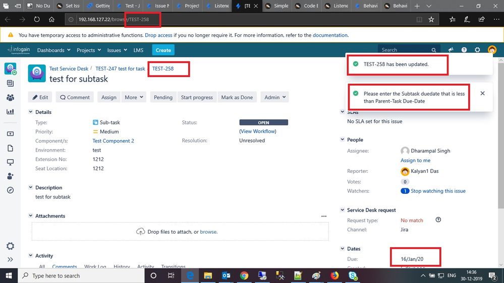

The problem is that when the condition fails then the Due-date will be update first and next the pop up alert is raised which i mentioned in the code but I am unable to restrict the due date update.
