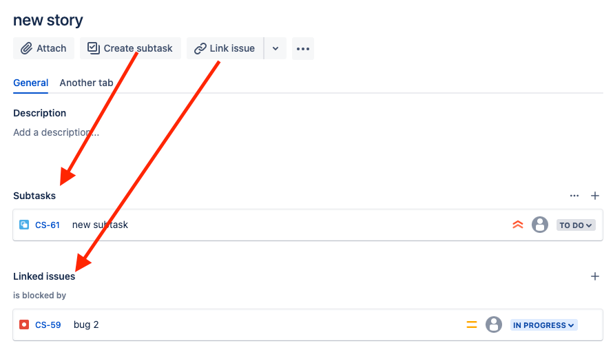

If you want to create a child issue of an Epic use the Add Child Issue button. Child issues of an Epic show in one list within the Epic. Jira automatically recognizes the parent/child relationship between the issues when you do this. If you don't want the parent/child relationship between the issues then use the Link Issue option. Generically linked issue appear within a separate list in the Epic.
Similarly if you want to add a child Sub-task to an issue use the Create Sub-task option and if you want to generically link issues together use the Link Issue option.
If the issue you are viewing has no Linked Issues, then when you want to use the generic Link Issue function, yes, the issue you want to link to needs to already exist. However, if an issue already has a Linked Issue you can click the + button and get an option to create and link a new issue.

If you are using the "Create Linked Issue" option that shows in the Linked Issues section of the parent issue, it is true that it will not automatically link to the issue you started from... unless you have included the Linked Issues field in your Create Issue dialog.
Within the Create Issue dialog you can display the Linked Issues field...Screen Shot 2022-10-03 at 5.14.34 PM.png
Then the next time you click the Create Linked Issue option, the issue from which you are starting will be automatically filled in to the Linked Issues field for the new issue you are creating. You just need to set the link type.

Vlad Klimkiv
August 17, 2023
I had the similar issue where it would not link newly created issues. I solved this by adding the "Linked Issues" to the "Create Issue" screen dialog box.
I was then able to use the "+ Create linked issue" button to create and automatically link the issue.
