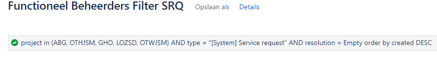

The query is
project in (ABG, OTHJSM, GHO, LOZSD, OTWJSM) AND resolution = Empty order by created DESC

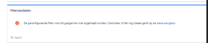

However, the "Filter Results Gadget" shows no results when logged in as one of those users.

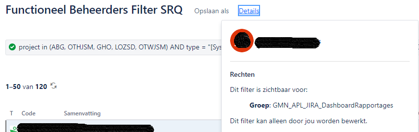

assuming so can you please verify that this user has access to the filter by going to the filter and clicking on details and inspecting the share.

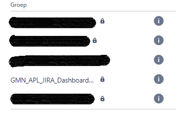

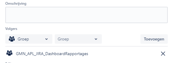

User is member of this group: AD groups.png
This group has access to the dashboard:

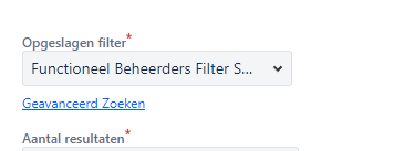

This group also has access to the specific filters i'm using in three "Filter Results" gadgets

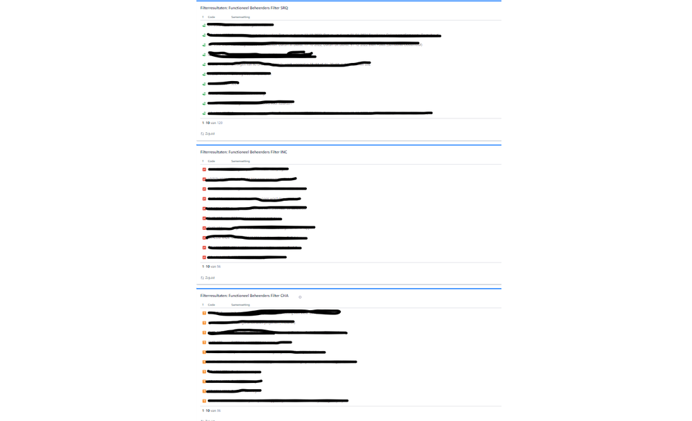

Yet, when I log in as this user, I get no results, as per the image i shared above. My OWN results are exactly correct:

But your last screenshot answers it.  The gadget is failing because the filter behind it is not valid.

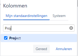

There's a quick test for this - go to the issue navigator and run a search.  Doesn't matter what it is; we're not looking at issues.  Now go to the "columns" button and type "project" into the search.  There will be more than one if I'm right.

Hi, thanks for your input on this so far. I have checked your suggestions, and here's what I have found so far:
  • We don't currently use any TMPs
    • No TMPs in the archive or recycling bin either
    • only used TMP once, over two years ago, as a test case
  • There are no other "projects" fields active
  • Following @Nic Brough -Adaptavist-  suggestion to check the columns, returns only 1 "project" field, which is filled with the Project NameColumns.PNG

  • Filter does work correctly when logged into my admin account:

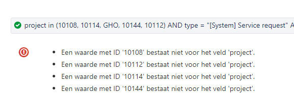

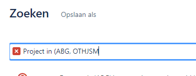

The next test I'd like to do is to get two people (one for which it works, and one for which it fails) to try the same JQL in the issue search.  The JQL you show us in the screenshot starting with "project in (10108, ".  Twice.
Test 1: copy and paste the JQL into the search.  Do they both get the same response (not the issues, just the warning/errors or a successful search)?
Test 2: Start typing the JQL into the search.  Do they both get the warning "10108 is not a valid entry for the project field"?

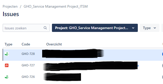

I have logged in as the same user as before. Under Projects, I can see the project containing al JSM issues this user should be able to see. Opening the project, I can see the screenshot below, and opening any issue shows the proper issue views: Project1.png
So the issue permissions are not the problem in this case.
Continuing with your next suggestions:
"Test 1: copy and paste the JQL into the search.  Do they both get the same response (not the issues, just the warning/errors or a successful search)?

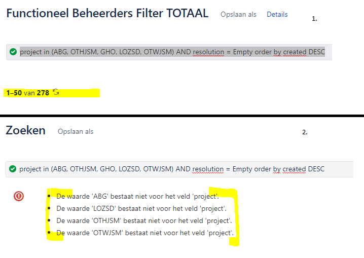

I have tried your suggestion on my admin account and on the same user account as before, and I get the following results. The top half of this image (marked 1.) is the view I get as an admin. JQL query is valid, and returns ~280 issues. The bottom half (marked 2.) is the user view, which returns a valid JQL query but also returns no issues. The text translates roughly to "The value '[Project Key]' does not exist for field 'Project'"
And, as per your last suggestion, I have tried to just type the JQL query out - which shows a red X as the user can't locate the projects I'm trying to include in the query:
"Test 2: Start typing the JQL into the search.  Do they both get the warning "10108 is not a valid entry for the project field"?"
And, for fun, I have also tried to find the projectcodes - which returns a valid JQL but again 0 issues as the value "Does not exist for the Project field":
I feel like we're homing in to the root cause - the pieces are there but I just gotta connect the puzzle. Thanks for your input so far!
October 18, 2022
I was barking up the wrong tree earlier.  I've just tried testing this properly.
Yes, you will get the "does not exist for" message from the JQL if a user cannot see the project.
Like • # people like this
Jack Brickey
October 18, 2022
That makes sense. So the answer is that Juul will need different filters for his dashboards.
