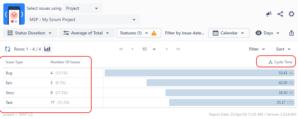

Gizem Gökçe _OBSS_
Atlassian Partner
April 25, 2024
Hello @Jenny Smedley ,
Welcome to the community!
There is no built in solution in Jira for this. So in order to track the cycle time I suggest you use a marketplace app. Timepiece - Time in Status for Jira , the oldest and leading Time in Status app in Atlassian Marketplace which is developed by my team at OBSS, has a report type that will meet your need.  Our app is available for both Jira Cloud, and Data Center.
Status Duration report (please see the screenshot above) which shows how much time each issue spent on each status. You can combine the time for multiple statuses to get metrics like Cycle Time, Lead Time, Resolution Time, Issue Age etc. Status Duration Report in Detail.png
For all numeric report types, you can calculate averages and sums of those durations grouped by the issue fields you select.
For example in your case you can group your issues by their epic and processes. So you can see the total or average cycle time for a particular epic in a particular process. You can use both system and custom fields to group your issues in your report.

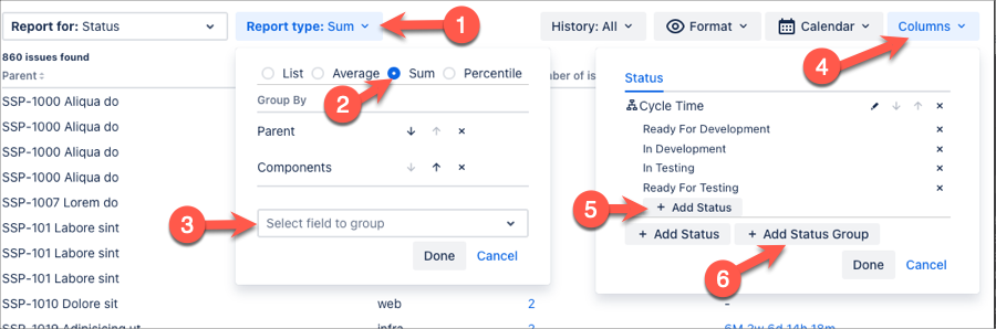

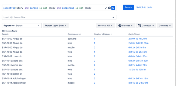

Mehmet A _Bloompeak_
Atlassian Partner
April 24, 2024
Hi @Jenny Smedley ðŸ‘‹
As far as I know Jira doesn't have a built-in solution for the report you mentioned. If you prefer using a marketplace app, you can try Status Time Reports app developed by our team. It mainly provides reports and gadgets based on how much time passed in each status. You can group issues to get cycle time by Epic and label. You can have a report similar to the below with the app. In our Jira we are using components field to differentiate stories under a epic. In your case you will group by labels.
