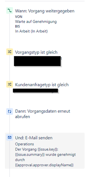

unfortunately I don't seem to make it work. I have a workflow configured where the status of the workflow is transitioned from "Warte auf Genehmigung" (waiting for approval) to "In Arbeit" (in progress).
Once the approval is complete, I want to inform the IT department, that the issue has been approved and can be worked on now.
This is how my Automation rule looks: Jira_Automation.png
The email looks like this:
Die Hardwareanforderung <a href="{{issue.url}}">{{issue.key}}: {{issue.summary}}</a> wurde genehmigt durch {{approval.approver.displayName}}.
Now whenever there is an email, the text just looks like this:
I am on Jira Cloud and supposedly the latest version. Would appreciate any help.

@Rodolfo Romero - Adaptavist The workflow has an approval step which is the transition from "Warte auf Genehmigung" to "In Arbeit". So whenever the approval is triggered and the workflow transitions to "In Arbeit", the rule is executed.
Is there another way to do it?

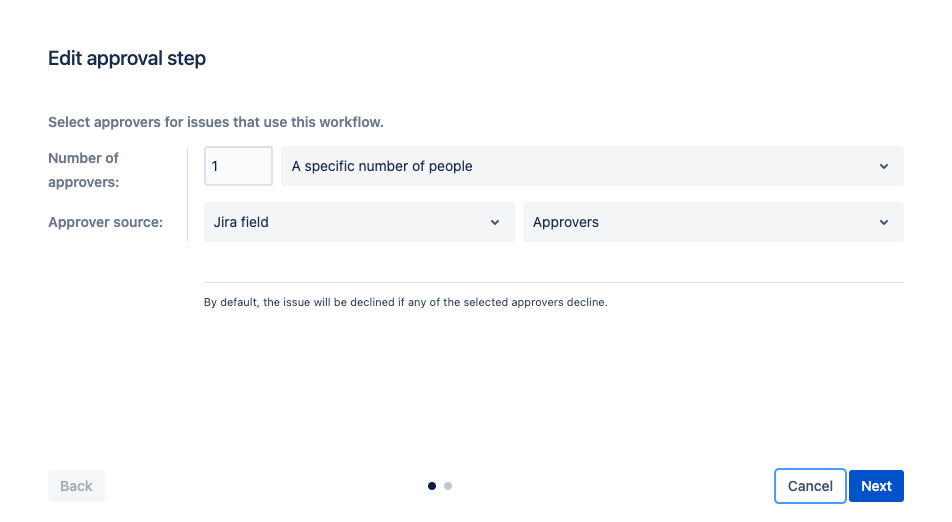

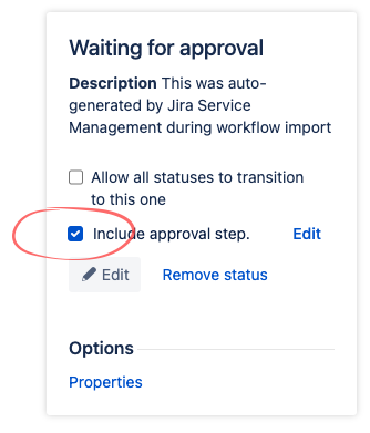

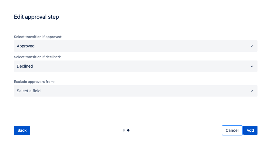

@Clemens Fischer a few things are needed for this to work.
  1. Your project needs to be a Jira Service Management project. This does not work in a Software project.
  2. The status in the workflow needs to have the "Include approval step" checked.
  3. The approval process needs to be configured.
After this is done, the values in the {{approval.approver.displayName}} will be available.
