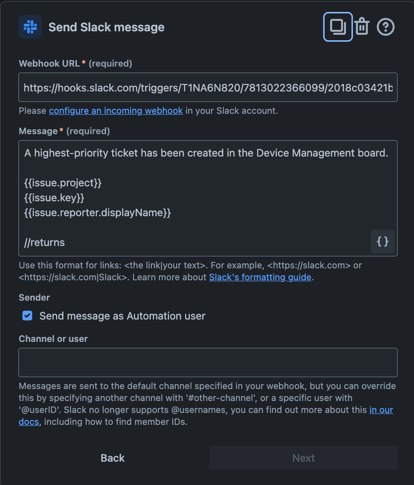

Here's how I assumed I would do this:

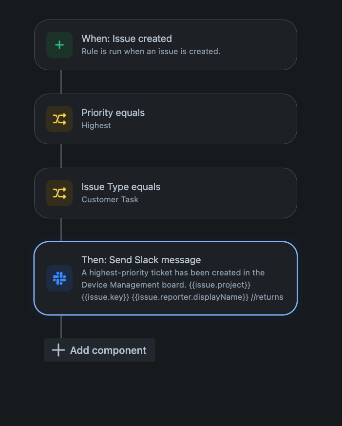

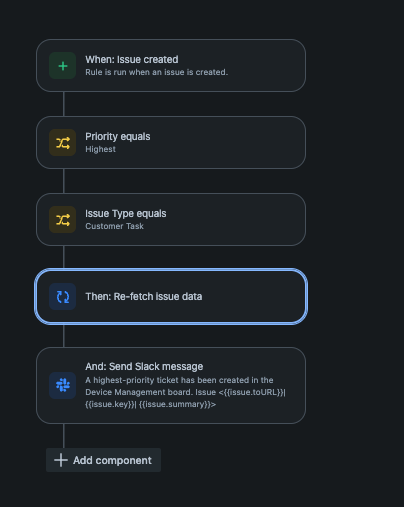

Here is the entire automation:

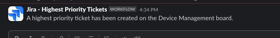

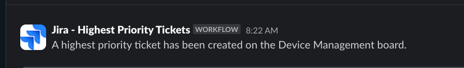

Here is the Slack message:

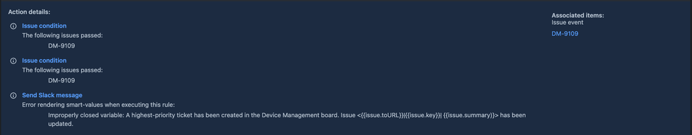

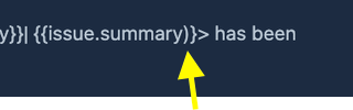

Trudy P Claspill
October 2, 2024
Hello @viraj
In the second example you provided you have a parentheses where you need a curly brace. That is what caused the error.

In the first example, what is the purpose of //returns in the message content? I have not seen that in the examples of Send Slack Message that I have found. If you remove that, what is the result?
viraj
October 2, 2024
@Trudy P Claspill
Thank you, just fixed that! However, even with that change, it still does not output those fields in the message:
Trudy P Claspill
October 2, 2024
What did you change? From which version of the rule is that last Slack message being produced?
Please provide new images of your rule and the details of the Send Slack Message component.

@Trudy P Claspill I changed the error you pointed out. See below:

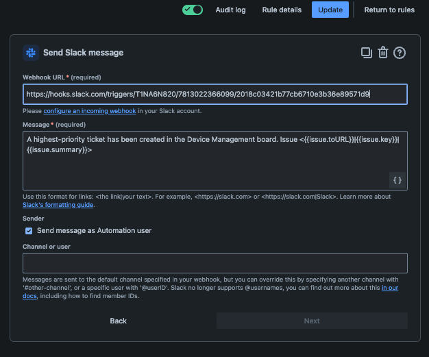

I don't have a Slack environment where I can test this, so these suggestions are just guesses.
1. Try removing all the new-lines in the message so that it is one long string of text. Maybe the new lines are causing a problem.
2. Try adding a Re-fetch Data action before the Send Slack Message action.
You may be encountering a condition where the rule is triggered so fast and the Send Slack Message action is happening before all data has been committed to the database.
viraj
October 7, 2024
@Trudy P Claspill I tried both of these but it didn't work :(
Screenshot 2024-10-07 at 2.38.25 PM.pngScreenshot 2024-10-07 at 2.38.23 PM.png

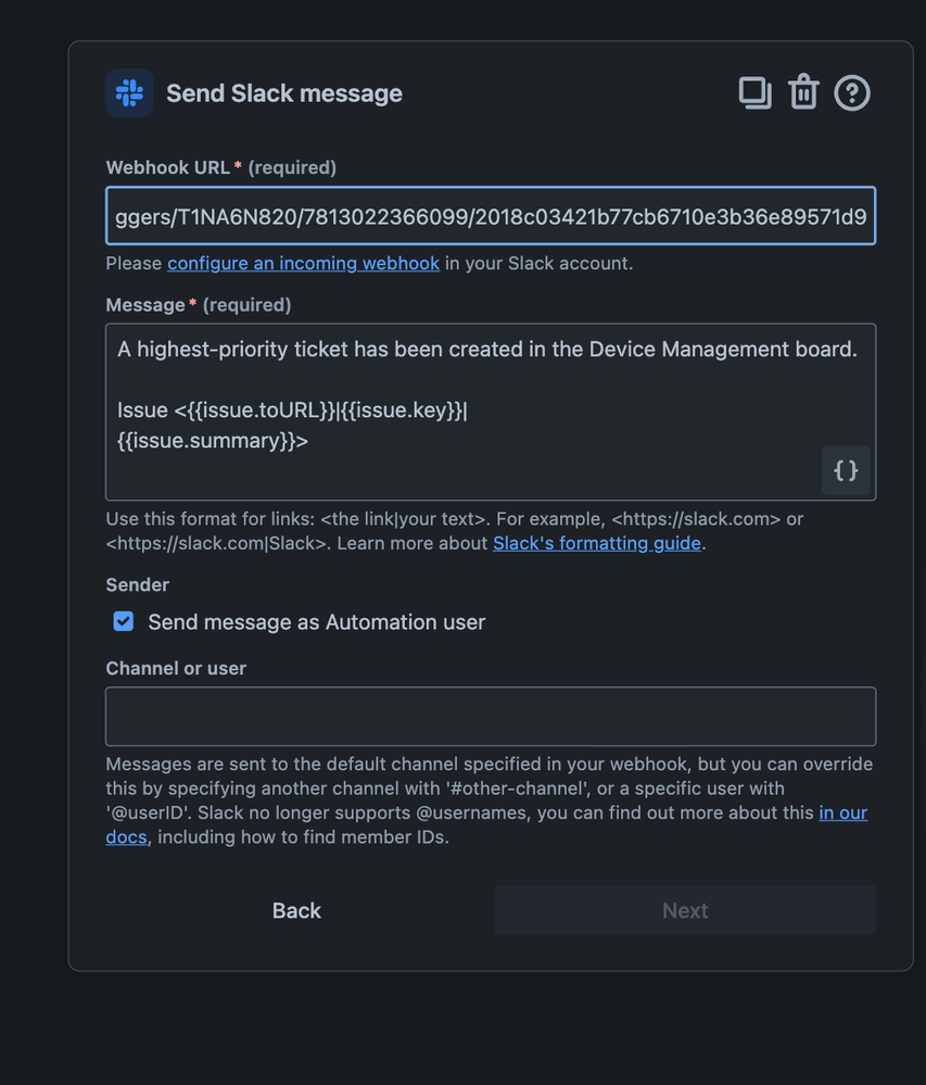

I see that you are using this syntax in the smart values section:
<{{issue.toUrl}}|{{issue.key}}|{{issue.summary}}>
The help text below the Message input field says:
Use this format for links: <the link|your text>. For example, <https://slack.com> or <https://slack.com|Slack>. Learn more about Slack's formatting guide.
I am guessing that you are trying to provide a link in your message because you are using <> and included {{issue.toURL}}|
However your syntax includes two of the pipe characters (the vertical bar | ), where the example shows only one. I wonder if that could be causing a transformation problem. If you want the message to show the issue key and summary which the entire text of both associated to a link to the issue, try removing the second pipe character in your syntax.
Again, I note that I don't have an environment in which to test messages sent to Slack. I am basing my suggestions on documentation that is available on the internet and my own deductive reasoning.
