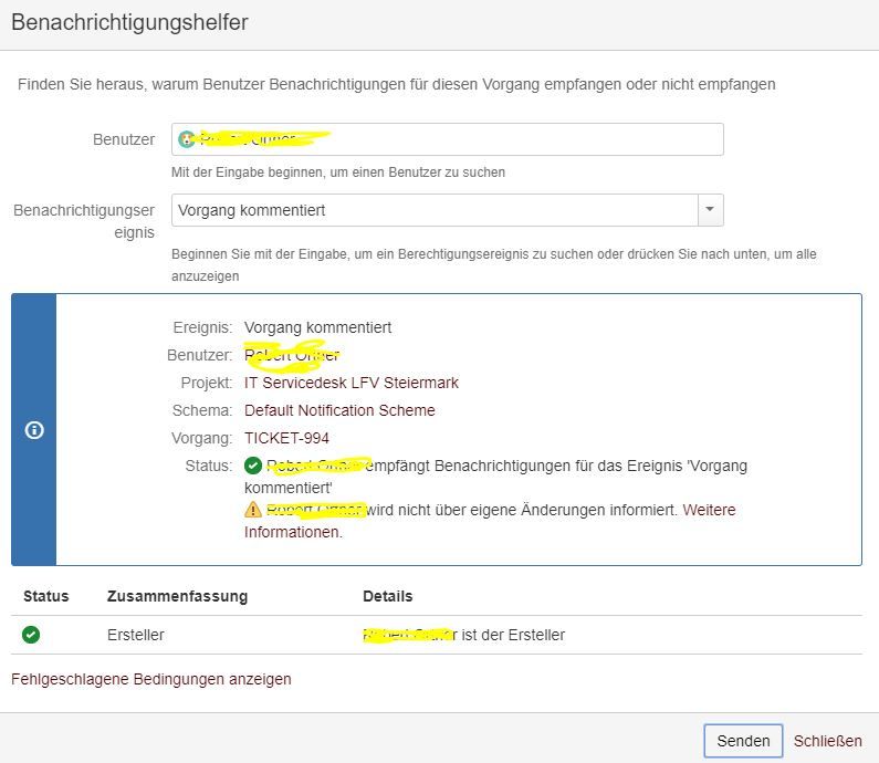

No. At the moment the User don't get any notification. This is how the testuser is configurated at the moment.notification3.JPG

Hmm, that's weird.
According to your screenshots and this users configuration, it should be fine.
I'll try to recap this all in my words what I understood and what I think is configured, that helps me thinking out loud and maybe you will see something that's different.
The Scenario is:
  • Max Mustermann (MM) creates an issue and is by that the reporter of the issue.
  • Karl Weber is adding a comment
  • MM is NOT getting a notification
Your configuration is:
  • MM can recieve emails, and does not have any email-rules, that moves or deletes incoming emails. There is no Spam-Filter (or spam-folder is checked for emails)
  • MM is an active user in the jira-servicedesk-user group
  • MM has permissions for the project (at least "Browse Project" and "Create Issue")
  • The notification scheme is configured that the Author is notified on "Issue Commented"
  • Outgoing Email is configured and your mailserver accepts emails from that sender
While writing this down, I noticed we did not have a look on the permissions.
Does the test-user have permission to see (Browse Project) the issues. Jira will only send notifications, if the user can see the issue. That might be the difference to the case when the user is in the admin group, as he can see the issue then.

Hello! Yes!!! This was the missing link! After setting this permission (Browse Project) the users get their notifications!
Thanks a lot!

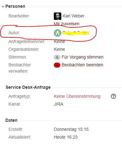

Karl Weber
May 23, 2018
Hi! I think it is set up correctly.... But still no Notification to the user:
