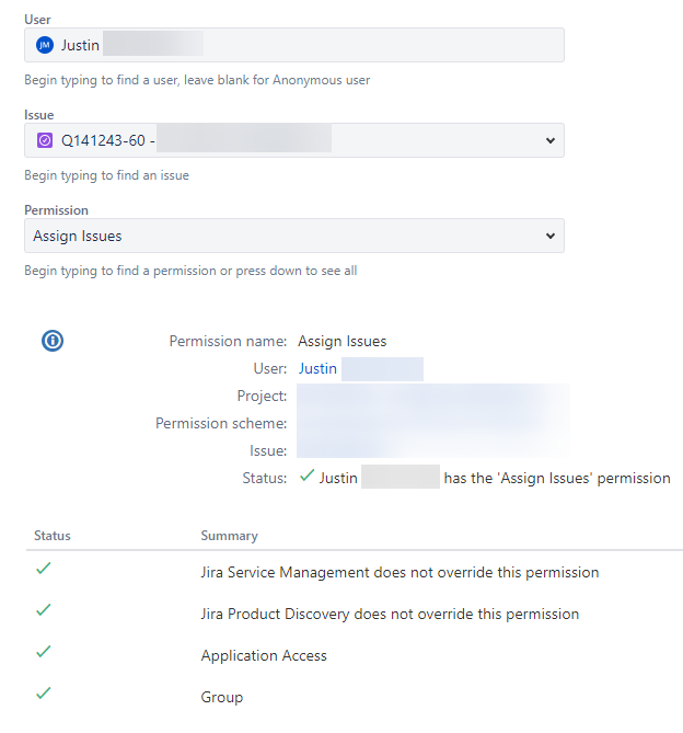

We have several users that cannot update the Assignee field. This has happened somewhat recently, and I do not know of any changes that have been made. The permission helper looks fine, but the user still receives "Assignee cannot be edited" when trying to assign issues. Below is one example of the permission helper screen:

When using the Permissions Helper there may be a link at the bottom to show failed conditions. Did your results include that link? Were there any relevant failed conditions?

Yes it is hard to tell because the screenshot is all white, but there were no failed conditions for this user.
