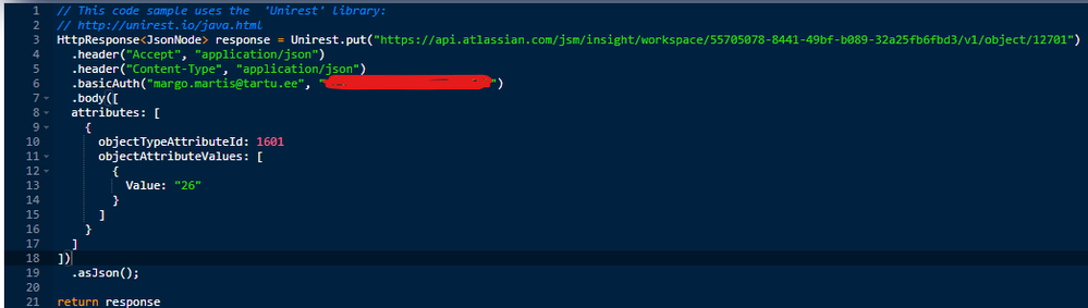

I am stuck trying to change Inisght object attribute values via REST API. The code i am using right now:
Response status is 200, but no changes have been made to Insight object, everything remains same.

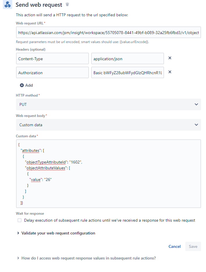

What could be the solution to get this working?

Tanel Käomets
July 21, 2022
ObjectTypeID is not needed.
The whole reason why it did not work is because from .body onwords the {} brackets have to be replaced with [], after that the code works fine.
