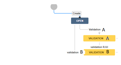

yes; i'm writing a post function in java to modify the status of a issue just after creation
my Workflow is like that :
for updating my transiton by
TransitionValidationResult validationResult = issueService.validateTransition(user,
issue.getId(), 11, issueInputParameters);
11 is the status ID
The issue is created but with status Open(==>i want it to be created with status Validation A if a value of costumfield is not empty)
with  this error :
It seems that you have tried to perform a workflow operation  that is not valid for the current state of this issue
With ScriptRunner , we can do the same thing, but i need to do it with java.
What did i do wrong?

No, i'm sure of status ID
Status statut = statusManager.getStatus(issue.getStatusId());//open
com.opensymphony.workflow.loader.StepDescriptor currentStep = workFlow.getLinkedStep(statut);
List<ActionDescriptor> actions = currentStep.getActions();
for (ActionDescriptor action : actions) {
System.out.println(action.getName() + "===" + action.getId());
Any other idea ?
Thanks

I corrected my code :
if ("Validation A".equals(action.getName()))
ApplicationUser currentUser = issue.getCreator();
IssueService issueService = ComponentAccessor.getIssueService();
IssueInputParameters parameters = issueService.newIssueInputParameters();
IssueService.TransitionValidationResult validationResult = issueService.validateTransition(currentUser, issue.getId(), action.getId(), parameters);
if (validationResult.isValid()) {
IssueService.IssueResult result = issueService.transition(currentUser, validationResult);
}else {
for (String msg : validationResult.getErrorCollection().getErrorMessages()) {
System.out.println("===>" + msg);
break;
But i got the same error ==>
"It seems that you have tried to perform a workflow operation (Validation A) that is not valid for the current state of this issue "
What i did wrong??
Thanks for help

Make sure that this post function is last in the list of your post functions
Z-EL
April 17, 2018
It is the last one but it doesn't work.
Alexey Matveev
April 17, 2018
The error means that the action can not be performed. Do you have any validators or conditions in the action?
Z-EL
April 17, 2018
No, i have no validators and no conditions in the action
