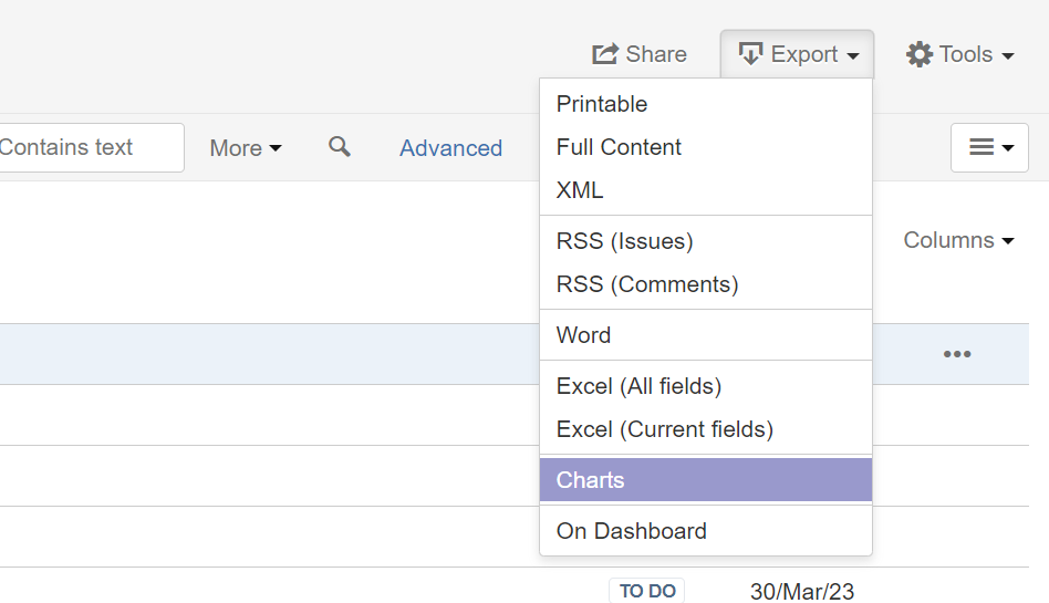

Regarding CSV export –I can not export tickets in csv file because these options are missing.
Please refer attached
Version : v7.1.2

Hi @Fabio Racobaldo _Catworkx_ ,
I followed all the above steps.
After adding Module lines, it disabled Issue View plugin itself in the JIRA.
SO I had to revert back changes.
Please could you share a screenshot about the current situation about modules within Issue Views Plugin?
