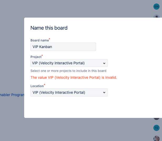

I am trying to create a new kanban board and have it be part of the above (existing) project. However, when I attempt to create a new board and add to the project, the project is not found. See attached screenshots. I can't create a new kanban either and use the same project name as it says it is already in use, but Jira will not find the project when I attempt to add it to an existing project.

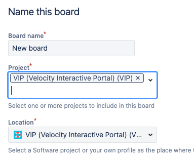

I created a new project in my environment and named it
VIP (Velocity Interactive Portal)
If I type that text into the Create Board > Project pull down field and exit the field then I get the same message you see. If I instead pull down the field and select the project then I see this.
You need to select the value from the list, not just type it in.

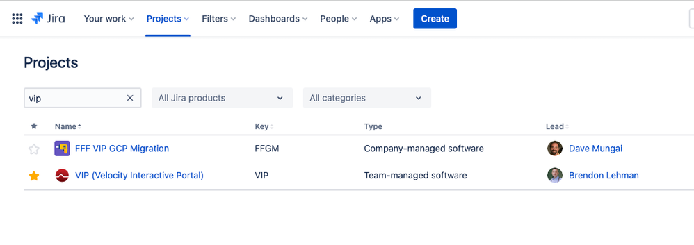

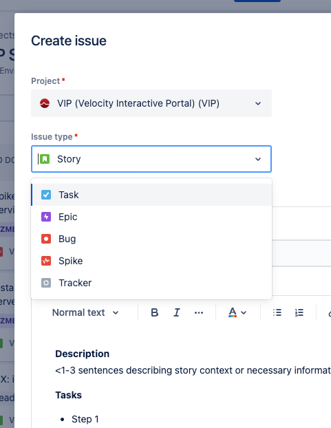

The VIP project is team-managed project - I am the lead. See screenshot.
Screenshot shows all projects that shows the VIP listed.

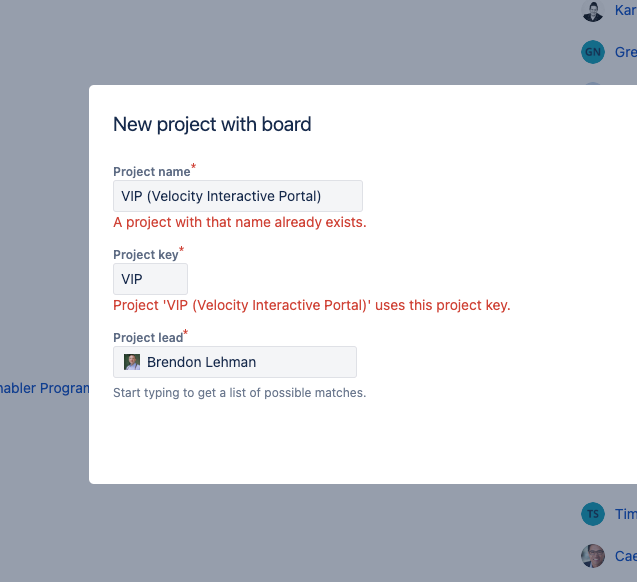

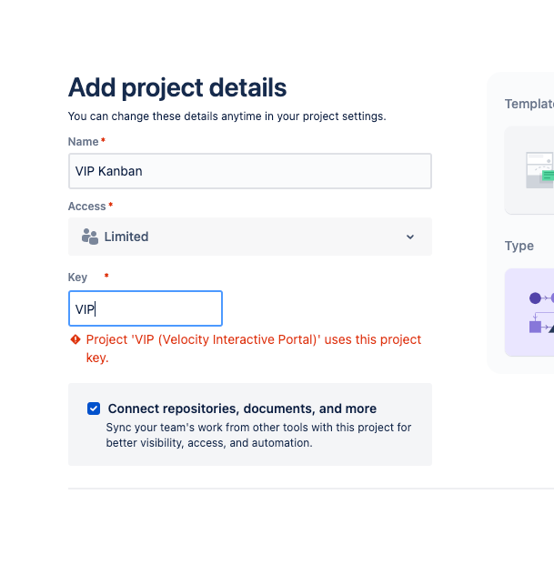

When I click, create 'project' > 'kanban' > I add the details... when I attempt to use VIP as the 'key' I get the following error:

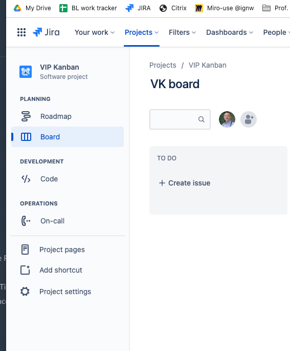

Lastly, I can create an entire new "software project" named VIP Kanban but there is no linkage to the existing VIP project...

Trudy P Claspill
August 24, 2022
Hello @Brendon Lehman
Ah, I have all the pieces now. Sorry this took so long.
Team Managed projects support only one board that will show up as the board in the navigation pane for that project.
You can manually create more boards (from the View All Boards screen at https://<yourURL>/jira/boards). However...
1. You have to make the board based on an Existing Saved Filter. You can't make the board based on an Existing Project because the dialog will not allow you to select a Team Managed Software project. So, create a Saved Filter for the issues in the Team Managed project, then manually create the board based on the Saved Filter.
2. You will not be able to set the Location (in the Create Board dialog) to the Team Managed project, because currently they support only the original board being "attached" to the project.
3. Note that there are some different behaviors and functionality between boards created manually and boards created automatically for Team Managed projects. You may want to review this post and the associated comments.
https://community.atlassian.com/t5/Jira-Software-articles/Multiple-boards-in-Business-and-Team-Managed-Projects-You-bet/ba-p/1719761

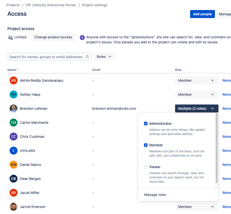

What level of permissions do you have in Jira? Could it be possible that you dont have permissions to that project?
Brendon Lehman
August 24, 2022
I am the Lead on the project. I have Admin and Member access.
