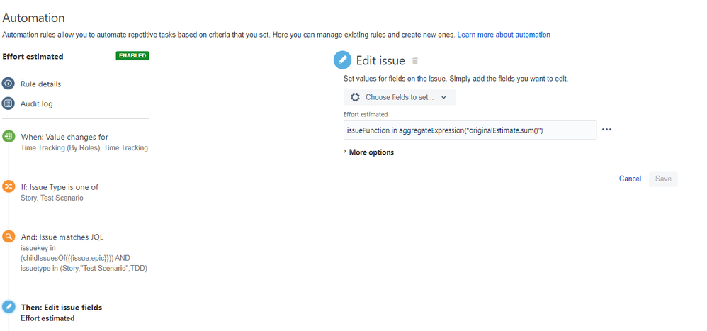

Farrukh Elahi
October 24, 2023
Hey Bill,
Thank you for your response!
I have added the screenshots, I think I can't use a function while setting the value of a field.

Bill Sheboy
October 24, 2023
Thanks for posting your rule images.
You are trying to use ScriptRunner functions in the automation for Jira rule to sum the values, and I do not believe that is possible: automation rules do not understand things like aggregateExpression().  I recommend checking the ScriptRunner documentation if you want to try that without an automation rule.

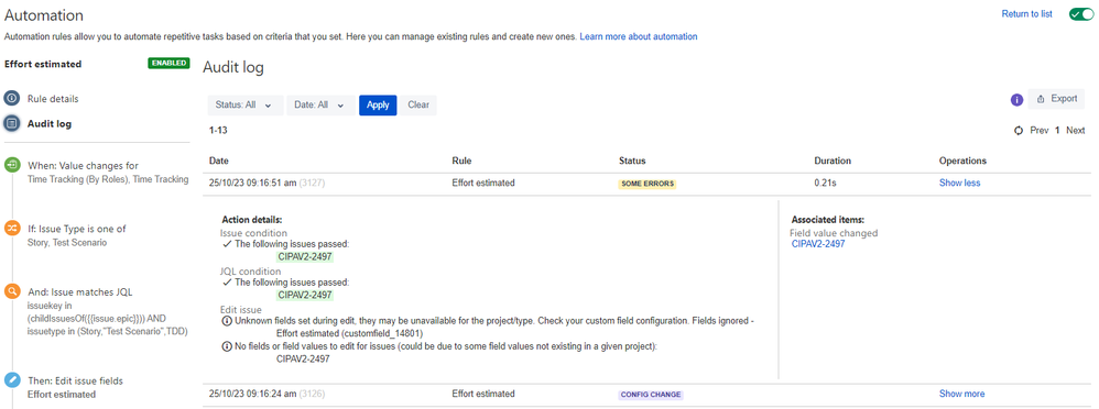

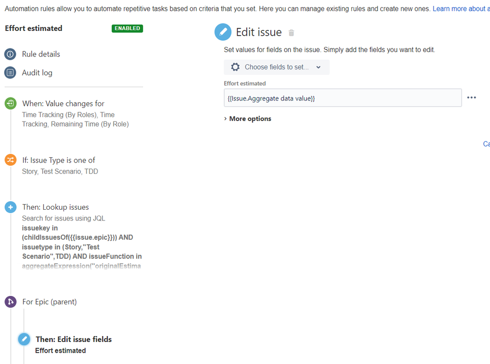

Issue function is working in JQL but still I'm unable to set aggregate data value. There are no errors in audit logs but the field is not getting updated with the correct value, any leads would be highly appreciated. I have tried following values but no luck:
{{Issue.Aggregate data value}}
{{issue.epic.lookupIssues.originalEstimate.sum}}
{{lookupIssues.originalEstimate.sum}}

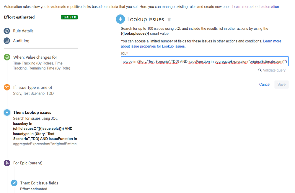

I think its Jira Data Center. The help text says it supports lookup issues but I'm not getting any results.

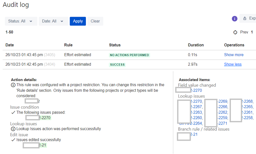

Bill Sheboy
October 26, 2023
According to the audit log you showed, the lookup issues is getting issues back.
If you use the JQL for the lookup issues, and the example issue when the rule triggered, please try to run that JQL stand-alone with an issue search.
Then check if any of those issues have an original estimate.
I suspect the problem may be the inclusion of the aggregateExpression() function in the JQL.  As you are using the Lookup Issues to perform the sum, the aggregate should no longer be needed.
Farrukh Elahi
October 26, 2023

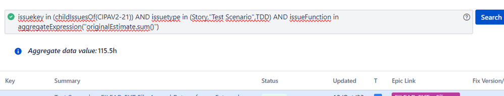

I have removed the aggregateExpression() function, but the following smart value is not returning anything:
{{lookupIssues.timetracking.originalEstimateSeconds.sum}}
When I run the same query in JQL, it works fine and returns aggregate data value (please see capture4.png below)
Probably this smart value is not supported, just for testing I tried {{issue.fields.aggregatetimeoriginalestimate}} and it is returning the Original Estimate of the triggered issue.
