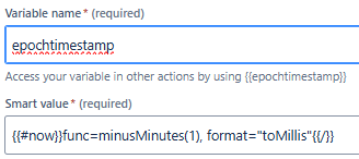

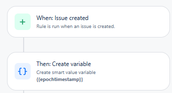

So now you can build your automation like this;
So the epochtimestamp here is set to 1 minute before now (in order to search the logs for the past minute)

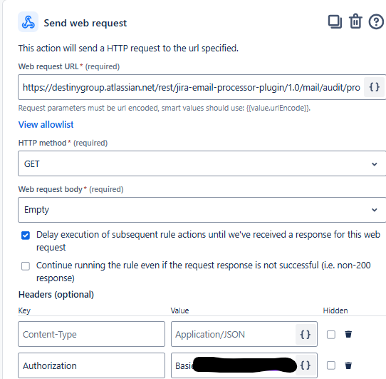

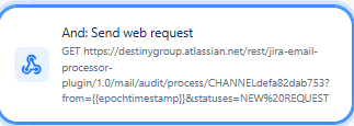

Now we issue our Web Request. Here's the configuration:

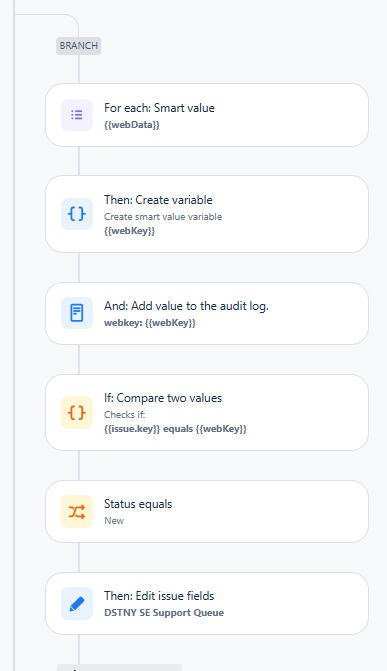

Now, for each email address you will need to branch out to perform some tests:

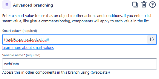

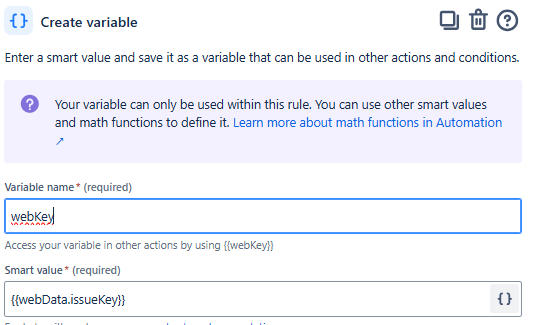

What we are doing here is creating a variable called webKey from a value captured in the webResponse by branching on the webData field:
Now you have extracted an issue.key from the response of your Web Request, you can compare it to the actual issue.key of the Trigger issue.
If it's a match you can perform an action such as enter a value into a custom field to identify a Support Queue.
As mentioned, the above, you need to repeat the branch for every email address, which means you also need to repeat the WebRequest using a different Channel ID.
This works well albeit being a tad 'clunky'.
